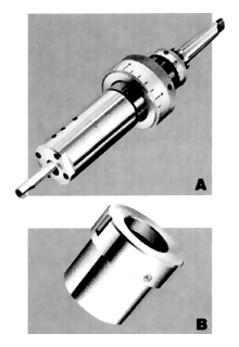

Figure 6: Jig-plate recessing head (A) and rotating bushing (B).

The pilots on the types of recessing heads discussed so far stop on the face of the component. Often, this is not possible due to the part configuration, or because it is undesirable to exert force on the part. In these applications, a jig-plate tool can be used (Figure 6). Rather than piloting off the workpiece, this type of recessing head operates off of a bearing, or rotating bushing, held in a jig plate above the part (Figure 7). Recessing heads are available in a variety of configurations to allow the user to locate and stop the tool on whatever surfaces are necessary (Figure 8).
During the approach stroke of a jig-plate tool on a drill press, for example, the head is rotating in the machine spindle and piloting in the bushing. The spindle is lowered. During the feed stroke, the adjustable stop collar bottoms against the face of the rotating bushing. Downward pressure causes compression of the recessing head, thereby actuating the slide mechanism that feeds the cutter out radially into the work. The correct DOC is obtained at the end of the feed stroke when the micrometer stop bottoms against the top of the outer body. Groove location is regulated by moving the adjustable stop collar up or down on the tool.
When using a jig-plate recessing head, it is necessary to hold the part rigidly in the fixture. Because it doesn't pilot off the face of the workpiece, the jig-plate tool is suitable for cutting grooves on thin-walled parts that can't withstand excessive force, and on parts where the face of the hole is on an angle.
