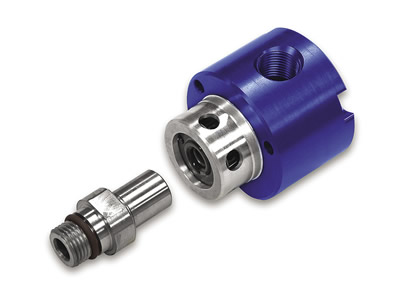

The parts of a rotary union. All images courtesy Deublin.

In TSC systems, coolant flows through a rotary union into the machine spindle. Rotary unions are mechanical devices that move fluids from a stationary source, such as a pipe, to a rotating machine part.
The key components of typical rotary unions used in machine tools are:
■ A rotor that spins with the spindle;
■ a stationary element that closes against the rotor;
■ a housing that connects the stationary element to the hose supplying the fluid; and
■ seals that contain the fluid in the union.

Rotary unions without bearings (above) and bearing-supported ones (below) from Deublin feature the company's Pop-Off seal technology. The seals close when coolant pressure is applied to contain the coolant and "pop off," or separate slightly, in the absence of coolant pressure to allow dry machining.

Rotary union buyers must also choose between offerings with bearings and those without. One-piece unions that connect the rotor and housing with one or more bearings are relatively easy to install and replace. On the other hand, unions that lack bearings are smaller, handle higher speeds and vibrate less. Their two-piece design makes mounting more difficult, however.
