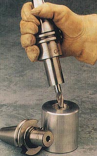

Figure 4: Once a new tool is inserted in the toolholder, the assembly is placed in a cooling block to draw the heat out of the toolholder.

The key component of a shrink-fit toolholding system is the induction-heating unit. The solid-state, self-contained unit is slightly smaller than a refrigerator and costs $19,000 to $20,000. To change tools, the user places the toolholder in a receptacle built into a shelf in the front of the unit. An induction coil that sits beneath the shelf and encircles the collar of the toolholder heats the holder to expand its bore (Figure 3). Different sizes of induction coils are available to accommodate different toolholder diameters. The largest coil accepts toolholders designed for tool-shank diameters as large as 2".
In about 7 seconds, the heat expands the toolholder’s bore a few thousandths of an inch, enough for the user to remove the dull tool and insert a sharp one. The heat is localized at the collar around the tool, so a user wearing gloves can handle the toolholder by its shank and remove the tool mounted in the toolholder without fear of being burned. Once the new tool is in place, the user sets the assembly in a solid-aluminum cooling block, which draws heat from the heated area of the toolholder (Figure 4). Seconds after the assembly is placed in the block, the bore begins to shrink back to its original inner diameter, which is slightly smaller than the outer diameter (OD) of the tool shank. The resulting contraction exerts uniform pressure around the surface of the tool shank. The entire process, from the time the toolholder is inserted into the induction-heating unit to the time it is ready to be mounted once again into the machine tool, takes about 30 seconds.
The induction-heating unit gives the operator total control over the heating process. Larger toolholders, because their ODs are relatively close to the coil, are heated more efficiently by the unit, and thus, require less power to heat them to the proper temperature than smaller toolholders do. The heating unit’s controls allow the operator to vary power to regulate the amount of energy sent into the coil. A normal setting for tools from 1/4" through 1 1/2" in diameter is 70 percent of full power.
The unit also allows the operator to control the heating of the toolholder by adjusting the cycle time. The automatic control can be set to keep the heating unit on from 1 to 22 seconds. The normal cycle time is 7 seconds. By setting the unit for a short cycle time, the operator can keep the heat concentrated in the clamping area. The toolholder will be out of the unit and in the cooling block before the heat can travel to other parts of the toolholder. A guide is available that offers suggested cycle times and power settings based on the diameter of the toolholder, but some trial and error may be necessary to find a setting that ensures sufficient heat to open the bore of a toolholder without overheating it.
Once a shop has established the correct power and cycle settings for its toolholders, it can use the heating unit’s internal control to regulate the power to the coil and the cycle time. When the internal control is engaged, the front-panel controls are disengaged. This feature prevents users from sending too much power into the coil and overheating tools and toolholders, which may shorten the lives of these components. The operator can maintain even tighter control of the heating process by using an optional infrared sensor, which detects the amount of heat in the toolholder. When the toolholder reaches a preset temperature, the unit shuts off the power automatically.
The heating unit and toolholder are further protected by a hold-off cycle that automatically shuts down the machine for 12 to 15 seconds after the heating cycle. During this cycle, the unit pumps water through the coil to keep the coil at its standard operating temperature. It also prevents the operator from rapidly recycling the unit and overheating the toolholder.
