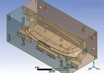

A plastic injection molding tool in Ansys’ DesignModeler software.

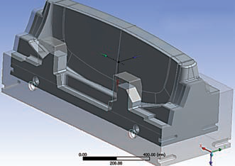

Tool size per industry guidelines (outer) vs. an FEA-optimized tool.
