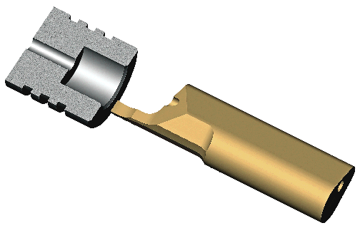

A Microbit ID grooving tool from Thinbit for diameters 0.125 " and larger.

According to Drape, the main challenge for ID grooving in miniature parts is the tiny tools’ relative lack of strength. “When you are going into a 1mm bore, you need a tool that has to fit axially into that 1mm bore and then apply radial force to [the bore]. This cutting pressure typically tries to bend the tool dramatically, causing form and chatter problems as well as tool breakage and chip evacuation issues,” he said.
A typical solid-carbide grooving tool looks like an L, and the leg (noncutting) portion has to fit within the bore diameter. For a 2mm bore, that means the most the noncutting edge can be is 2mm minus a clearance. The foot portion of the L-shape has to be even smaller than the leg portion, which weakens it dramatically. Small-diameter bores also limit groove depth. “If you want to put a groove in a 2mm-dia. bore, the most tmax (radial DOC) is 0.2mm,” said Drape. Consider the machining of a 2mm bore. A grooving tool with a 1mm leg would require a safety factor of 0.2mm between the leg and the component. Theoretically, then, the tool could cut a 0.8mm-deep groove. However, with only 1mm of leg, the tool will probably be too weak to actually cut a groove of that depth, and would be limited instead to a 0.2mm groove depth, said Drape.

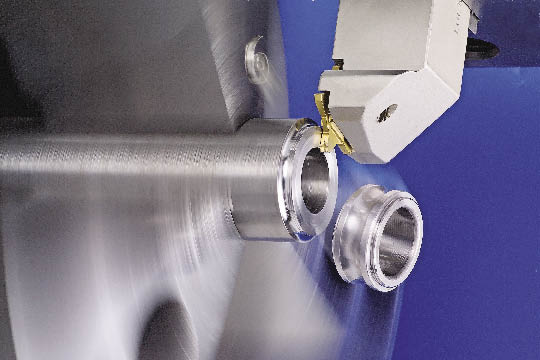

Courtesy of HORN
A 6mm-dia. face grooving operation.
Chip management factors include insert and chipbreaker geometry as well as the feeds, speeds and toolpath. “In all grooving operations [including threading], cutting pressure is very high compared to other cutting [operations] because of the length of the cutting edge required to make the groove and the confined chip-removal space,” said Myers. “The reduction of this cutting pressure is critical to successful grooving and can be accomplished mainly by using proper feeds and speeds, tool design and lubricants.” The recommended speeds and feeds depend on the type and hardness of the workpiece material, according to Myers. He recommends lubricants with high lubricity for miniature part applications.

Using an indexable insert for grooving is limited by bore diameter. In most cases, the smallest bore diameter for these types of tools is 0.708 ", according to Drape. There may be indexable tools for smaller bores but the radial DOC achievable with such tools is typically less than 0.040 ".
“That being said, you still can use a replaceable insert tool for grooving in bores as small as 0.300 " in diameter,” Drape said. “These are usually single-edge replaceable inserts, but they provide a greater axial depth into the component and a more reasonable cost for longer reaches than a solid-carbide tool could provide.”
Solid-carbide tools are preferable for the smallest bores, but shops should keep in mind that some manufacturers, HORN included, call small solid-carbide tools inserts because they typically require a specific toolholder, said Drape.
According to King of Thinbit, solid-carbide tools are typically preferred in most ID grooving applications under 0.500 ". While these tools are more expensive, they are stronger. “With inserts, you must reduce the strength of the toolholder to have a clamping mechanism for the insert and a place to mount the insert,” said King. This is not required for small solid-carbide grooving tools.
Still, he agreed that it is generally best to use inserts whenever possible due to cost concerns. “Most [grooving tool] manufacturers go down to 5/16 ", or an 8mm bore diameter, with inserts,” said King. “Regarding groove width, we go to 0.004 " as a standard size and offer every 0.001 " increment to 0.250 ". The trend is to smaller parts that require smaller grooves.”
Myers of Denitool agreed that indexable grooving inserts should always be considered when the part or bore size permits access. He noted that Denitool’s smallest insert grooving system can enter a 0.150 " bore. “Insert inscribed circle sizes produced by Denitool have decreased over the past 5 years,” said Myers. “Our partnerships with key customers worldwide have indicated a clear need for development in this area.”

OD grooving is easiest to generate by side turning or plunging, starting at around 0.020 " wide, according to Iscar’s Kelling. For this application, Iscar recommends its PENTACUT insert with five cutting edges and a molded chipformer.
For ID grooving and undercutting, the company recommends a coolant-feed, solid-carbide insert, starting at a 0.002 " radius and a 0.024 " ID.
For face grooving miniature parts, Iscar recommends its standard solid-carbide inserts, which start at 1mm wide and an ID of 0.236 ".
