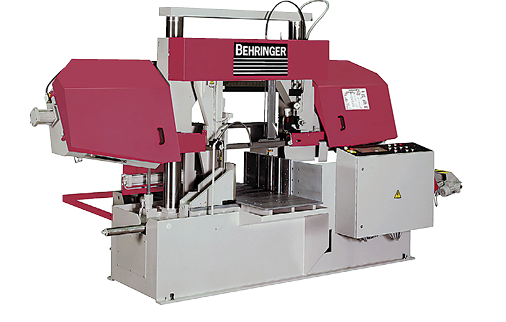

Behringer Copy (2) of HBP530A freigestellt.psd
Courtesy of Behringer
A Behringer HBP 530A automatic bandsaw.
