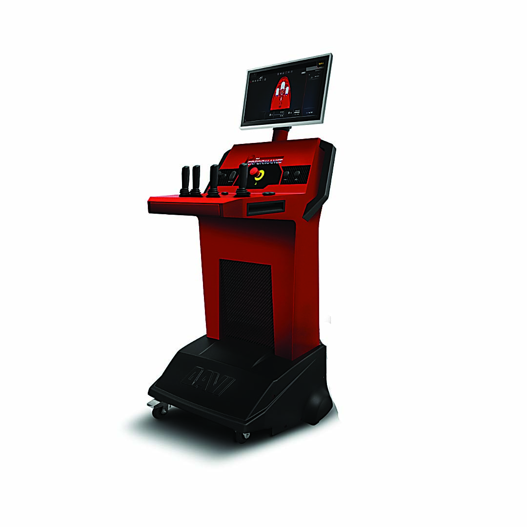

Davi's two higher-end plate rolling machine CNCs – the iRoll eXtreme and iRoll Performance – contain internal material libraries, and once a material is selected, the control already knows the material's characteristics.
Davi's two higher-end plate rolling machine CNCs – the iRoll eXtreme and iRoll Performance – contain internal material libraries, and once a material is selected, the control already knows the material's characteristics. Image courtesy of Davi Inc.
When it comes to determining proper rolling parameters, today's plate rolling machine CNC controls make it easier based on the material being processed. For instance, these advanced machine controls will prompt operators to enter four key pieces of data. Those are type of material (yield and tensile strength), thickness, width and desired rolling diameter. From this, the CNC calculates the program along with presets for the required pressure and side rolls movement – how far they need to rise to achieve a certain radius along with all other necessary parameters.

Such material databases are now part of a machine's control, which speeds the process immensely. For example, Davi's two higher-end plate rolling machine CNCs – the iRoll eXtreme and iRoll Performance – contain internal material libraries, and once a material is selected, the control already knows the material's characteristics.
These controls also allow shops to edit the material libraries, so they can further fine-tune the rolling process for their particular material types. This is especially helpful when material tensile and yield strength varies from batch to batch or from one supplier to the next.
