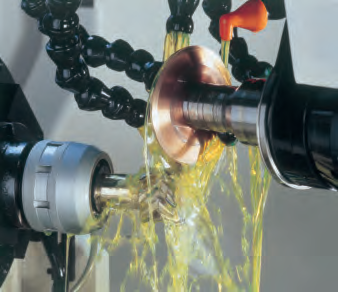

Courtesy of Vollmer
PCD cutting edges can be shaped via electrical erosion (EDG) with a tungsten-copper disc. The cobalt binder in the PCD tool conducts the electrical energy, and the electrical charge removes the diamond material. Here, the EDG disc in a Vollmer machine is in position at a tool before the flow of dielectric is started.
Vollmer’s Ries said wire EDM can offer an advantage compared to rotary erosion because it can create small inside radii and other complex tool features that a rotary disc can’t. On the other hand, he said, the rotary electrode is a thick, stiff piece of tungsten copper that, unlike a wire, does not offer any deflection. “It is much more rigid erosion, and all things being equal, you have a faster material-removal rate.” The advantage lessens, he said, when removing more than 0.3mm to 0.4 mm of excess PCD stock and wire EDMing becomes easier.

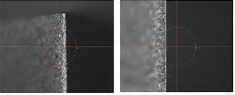

Courtesy of Walter
These 400× micrographs compare the 0.035µm Ra surface finish possible on a PCD cutting edge with conventional grinding (left) vs. the 0.10µm Ra finish produced by electrical discharge grinding on a Walter Power Diamond machine.
“There are some EDG or EDM units that can give you a very fine, crisp edge,” he said. But tools such as precision reamers used in aerospace and other applications may require tolerances within ±2.5µm. “You just can’t hold that kind of a tolerance in rotary erosion; there is a small degree of thermal damage and you just must have that smooth finish on the OD. For those tools, we rough the tool with EDG and leave a small amount of material, then OD grind to finish size to leave a real good finish.” For example, Walter offers a new fine-finishing EDG process that can produce a surface finish of 0.10µm Ra on a PCD tool, while the same tool can be ground to a finish as fine as 0.035µm Ra, according to the company.
Buchenroth said suitability of the EDG finish for a particular application depends on spark generator settings, which are specific to the machine and operator. The Walter machines, for example, allow adjustment of different generator parameters.
In general, he said, “The faster you burn, the more thermal damage and the rougher the tool finish. If the generator has been tweaked and tuned for a very fine finish, it takes a much longer time to run the tool. The finer the finish, the less damage there is to the diamond and the longer the tool life will be. But the price of the tool will be higher.”
PCD composition affects EDG performance, and PCD from different suppliers varies somewhat. “You have to tweak your settings according to that manufacturer’s PCD material,” Buchenroth said. West Ohio Tool is “ramping up on the PCD side pretty hard,” he added.
