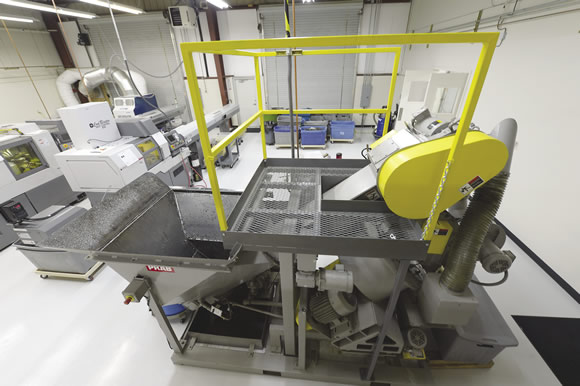

A PRAB chip processing system at Diablo Precision, ready to spin the next batch of metal chips. Image courtesy Diablo Precision.

One shop that needs no warning is Diablo Precision Inc., Hollister, Calif. President Conor Kelly takes pride in his shop’s green footprint and has made substantial efforts towards energy conservation, thermal management of the building and reduction of hazardous substances. This included switching six Swiss-style CNC screw machines to vegetable-based cutting oil, a move he admits wasn’t entirely environmental.
“We started out with a mineral oil, but it was pretty nasty-smelling stuff,” he said. “It was also quite viscous, so a lot of it stuck to the chips—we figured a big portion of our oil was ending up at the scrap recycler. Our local distributor recommended a vegetable-based product, Vascomill 22 from Blaser Swisslube. We were a little nervous about its cutting properties, of course, because it’s just a vegetable oil. But since the cost was about the same, we gave it a try.”
Kelly said the new oil worked much better than the old and there was an immediate 15 percent improvement in tool life. The operators were happy as well, knowing vegetable oil poses no risk of carcinogens or ill health effects, and no stink.
The new oil is also far less viscous, reducing the amount going out with the chips, but Diablo wasn’t done with its conservation efforts. The shop ordered a chip centrifuge and shredding unit from PRAB Inc. to get the chips as dry as possible before selling them for scrap. “Our oil consumption went way down, " Kelly said. "We probably recover about 95 percent of our oil from the chips now. At $1,600 a barrel, it’s a significant savings and good for the environment.”
On the shop’s machining centers, Kelly regularly skims tramp oil from the water-soluble cutting fluids, adjusts pH to the manufacturer’s recommendations and filters to a 1µm level. This extends fluid life and keeps it out of the recycler’s hands longer. As the shop grows, Kelly said he might streamline the process by investing in a sump cleaner.
