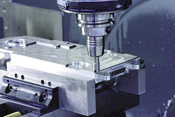

Schunk_PLATINUM.tif
Courtesy of Schunk
A corner-rounding operation on an aluminum workpiece using a balanced Tendo toolholder from Schunk.

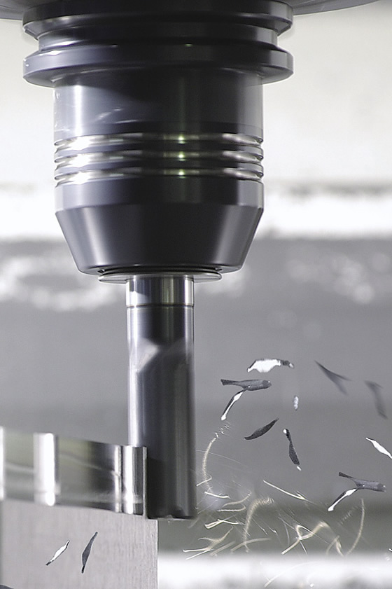

TENDO%20E%20compact2.tif
Courtesy of Schunk
High-speed milling aluminum with a Tendo E compact hydraulic workholder from Schunk.
The more weight added or the faster something spins, the greater the imbalance, regardless of a toolholder’s G value. Centrifugal force increases at the square of rotational speed, so as a spindle revs up, vibration increases exponentially.
For example, a toolholder imbalance headache at 3,000 rpm will be 25 times worse at 15,000 rpm. This is why a collet chuck rated at G2.5 might be perfectly fine at 10,000 rpm, but spin that same tooling assembly up to 50,000 rpm and you’ll likely be busy shopping for new machine tool spindle bearings before month’s end.

A toolmaker that offers factory-balanced holders is Morrisville, N.C.-based Schunk Inc. “We sell a ton of hydraulic holders. They have a seal, piston and screw on one side of the holder, which causes imbalance,” said Tooling Group Manager Matt Panosh. “We have to remove a large amount of material from the opposite side of the holder to offset this. Once this is done, however, the holders repeat very well.”

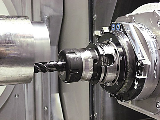

Someone who might take exception to this is Brendt Holden, president of tooling provider Haimer USA LLC, Villa Park, Ill. “With mechanical holders such as milling or collet chucks, the assembly should be balanced every time you change the cutting tool,” Holden said. “That’s because these types of holders contain moving components that don’t repeat exactly during clamping. Even hydraulic chucks are susceptible to imbalance as the fluid level changes during clamping.”
Nor does he agree with 9,000 rpm and above as the magic number for tool balancing. “We worked with a shop that bought a balancing machine for their first 20,000-rpm machining center. The owner decided that, as long as they had the capability, they might as well balance everything in the shop.”
The result, Holden explained, was surprising. Even on machines with 8,000-rpm spindles, the shop saw significant improvement in tool life and surface finish using the balanced holders. “The thing they were most thrilled about was the increase in metal removal,” he said. “Even running at 3,000 rpm, they were able to double the feed rates on many of their operations.”

Haimer_Balanceable%20collet%20chuck%20in%20action.tif
Courtesy of Haimer USA
A Haimer balanceable power collet chuck prepares to take an aggressive cut.

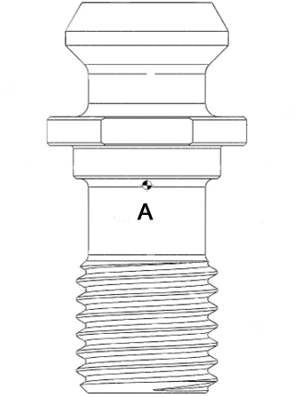

J%26M_RK11146HTwith%20threads%20front.tif
Courtesy of JM Performance Products
A thread relief (area A) eliminates expansion at the small end of a tapered toolholder, assuring a proper fit and reducing vibration.
Rowley pointed out an additional area of concern for those shops using CAT or BT toolholders, one that exacerbates an out-of-balance situation, is the spindle taper itself. At speeds greater than 10,000 rpm, he said long-taper spindles tend to “open up,” allowing the toolholder to move in the spindle. To make matters worse, a typical pull stud—especially one that’s been overtightened—can actually deform the threaded end of the toolholder, causing improper seating in the spindle.
“One of the things we do to combat this is move the threaded portion of the retention knob as deep into the toolholder as possible,” Rowley said. “This prevents the bellmouth you see on so many of these holders and, in turn, provides significantly more contact between the toolholder and spindle tapers. We also start and stop the threads exactly 180° apart. This is critical to maintaining proper balance.”
