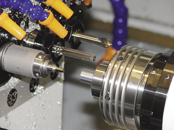

Rotary broaching being performed on the subspindle of a CNC Swiss-style machine.

One of the reasons rotary broaching is popular is it can be performed on a variety of machine tools, including Swiss-style machines, manual and automatic lathes, milling machines and vertical machining centers. This makes the process practical for machine shops.
“Rotary broaching eliminates secondary operations,” Laprade said. “Rather than blanking out a bunch of parts and then putting them on another machine tool to put the form in, a finished product comes out of the first machine.”

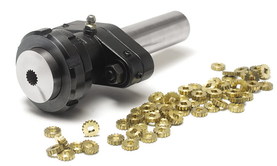

Rotary broaching requires two components: a toolholder specifically for rotary broaching and a broach tool. The rotary broach holder incorporates an internal live spindle, or free-spinning bearing, that holds the broach at a 1° angle relative to the centerline of the workpiece. While either the machine spindle or the toolholder body is rotating, pressure on each corner of the broach is constantly changing. This creates a chisel-type shearing action, cutting one corner at a time as the broach is fed through the workpiece to the desired depth.
In a turning machine, the toolholder body is stationary while its internal live spindle and the broach rotate, driven by the workpiece (see graphic on next page). Because the workpiece drives the broach, the process does not require live tooling. In a milling machine, the toolholder is mounted in and rotates with the machine spindle while the internal live spindle and broach remain stationary.
Courtesy of Slater Tools
This rotary broach toolholder and broach tool created these small brass parts with a square internal form and spline-shaped external form.

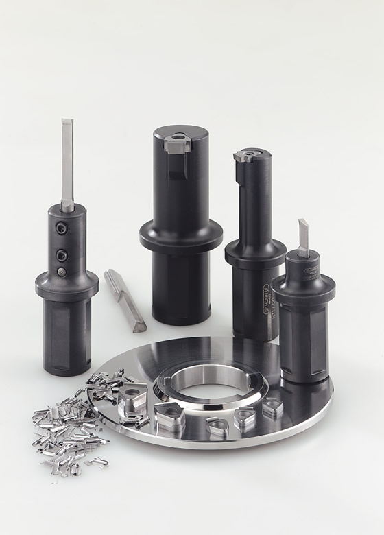

An option for producing polygon-shaped forms is using an insertable, single-point broaching tool. The single-point tool does not produce the whole form at once. Rather, it removes 0.001" to 0.003" (0.0254mm to 0.0762mm) of material during each pass.
“We consider it broaching because it is essentially shaving the part to the form we want to produce,” said Jason Farthing, marketing and sales coordinator for toolmaker Horn USA Inc., Franklin, Tenn. “With each pass, the tool gets farther and farther away from centerline on the X-axis and closer to the chuck until it reaches the required depth. This decreases tool pressure and the required machine horsepower because it is not cutting all that material at one time.”
Courtesy of Horn USA
Horn USA’s insertable, single-point broaching tools remove a minimal amount of material during each pass.
Standard single-point tools are used to broach keyways, hex shapes and lobular sockets, and specials can be ordered for internal and external applications. Standard tools are available with up to a 4.5:1 ratio for the tool length to bore ID.
Like a rotary broach, a single-point broaching tool can be applied on lathes and milling machines. “The tool allows users to eliminate secondary operations or the need to subcontract work,” Farthing said.
A relief groove, or undercut, must be machined into the part to create a ramp-down exit from the cut at the end of the broached area in order to evacuate chips.
Single-point broaching tools up to 0.551" (14mm) wide are available as standards. “If the user is producing a wider keyway, he needs a Y-axis to step back and forth,” Farthing said. “That is easy to do on a mill, but a lathe might have only two axes—Z and X. Without the Y-axis, the user would have to go to a wider, custom tool.”
Whether using a lathe or a mill for this process, it is important that it have a mechanical spindle lock. “Generally, if the machine has a C-axis, it has a mechanical lock on the spindle,” Farthing said.
Most single-point tools have a round shank with four flats for direct mounting in lathes and milling machines. The tool can be oriented in all four directions.
Standard tools for mounting in some live tooling (reciprocating) attachments, which allow a tool to rapidly move back and forth, are available as well. “However, reciprocating attachments have a limit on their stroke. They are made to drive only a small amount of material,” Farthing said.
