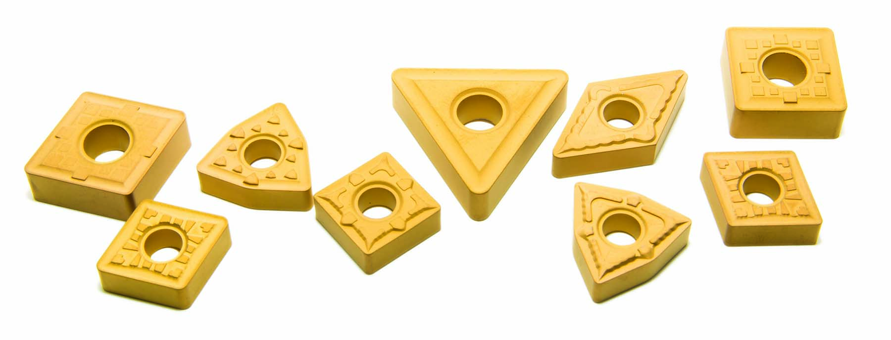

A selection of G5125+ inserts is shown.
A selection of G5125+ inserts is shown. Image courtesy of Greenleaf

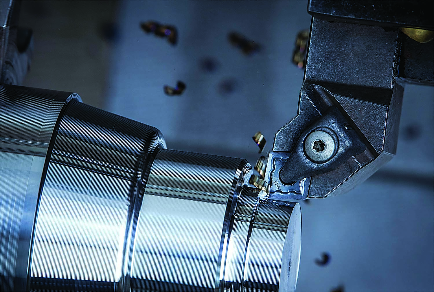

Although uncoated insert grades are still widely applied to machine heat-resistant superalloys and titanium alloys, Garud said uncoated grades are not recommended for cutting steel. Typically, CVD-coated grades are most effective for steel, such as Walter USA’s WPP20G.
Advances in coating technologies have enabled coated carbide to be nearly as smooth as uncoated polished carbide, Bokram said, so there are very few cases in which it is not beneficial to use coatings to extend tool life.
He concurred that CVD coatings, which are usually 10-µm-to-20-µm thick (0.0004" to 0.0008"), are more effective for rough turning steel than PVD coatings, which are limited to about 10-µm thick.
“This translates directly to longer tool life,” Bokram said.
In addition, a roughing insert tends to run at a moderate surface speed, which he said doesn’t generate enough heat to oxidize a PVD coating and activate its wear- and heat-resistant configurations.
“CVD coatings are already oxidized,” Bokram said. “They don’t need heat to transform their structures.”
To resist heat deformation when turning at high cutting speeds, Garud said Walter USA’s WPP05S grade has a coating with a high aluminum-oxide content and a TigerTec Silver coating.
“This grade allows speeds in excess of 1,200 to 1,300 sfm (366 to 396 m/min.) in some steels,” he said.

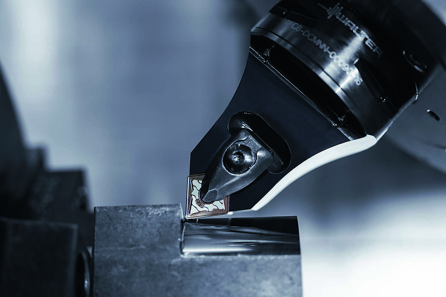

A CNMG insert turns a steel part.
A CNMG insert turns a steel part. Image courtesy of Walter USA

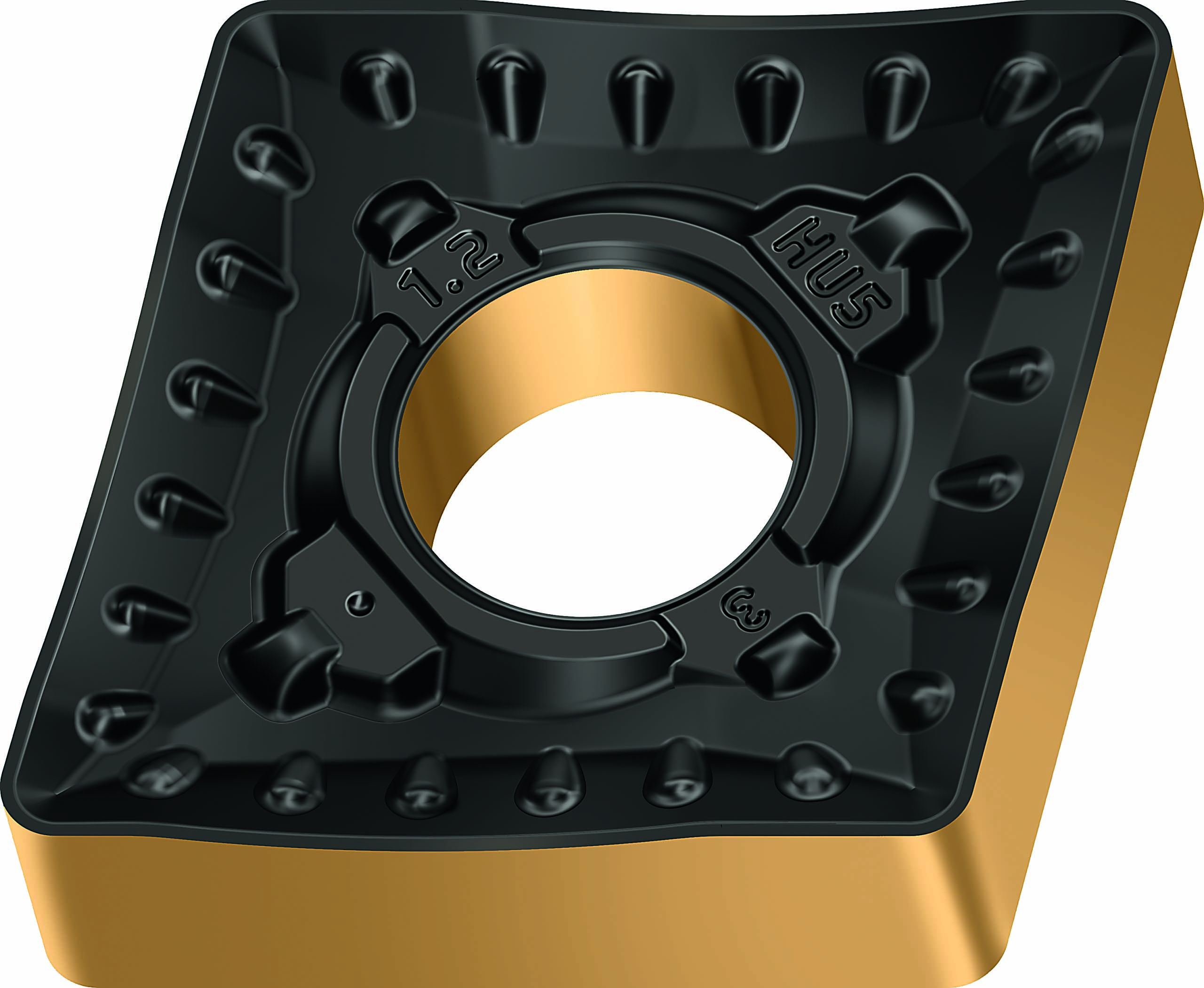

The HU5 is a single-sided, heavy-duty roughing geometry that also has a sharp, positive rake angle.
The HU5 is a single-sided, heavy-duty roughing geometry that also has a sharp, positive rake angle. Image courtesy of Walter USA

In addition, Garud said HU5 is a single-sided, heavy-duty roughing geometry that also has a sharp, positive rake angle.
“This makes it a ‘low cutting pressure’ geometry ideal for both stainless steels and steels,” he said.
