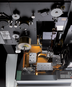

Wire EDMs that use an oil-based dielectric machine carbide workpieces without cobalt depletion. Photo credit: GF AgieCharmilles.
Courtesy of GF AgieCharmilles
Wire EDMs that use an oil-based dielectric machine carbide workpieces without cobalt depletion. This GF AgieCharmilles machine also features an automatic wire changer.

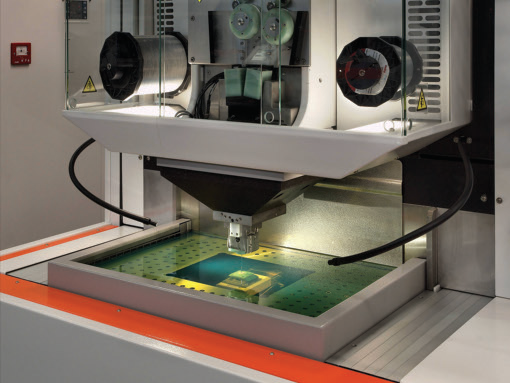

To switch wire size, the wire and guides are typically changed manually. However, some EDMs have automatic wire changers. When one wire spool is exhausted or the wire size needs to be changed, the machine automatically switches to another spool.
GF AgieCharmilles offers an automatic wire changer. “For example, say I have a carbide punch that needs a 0.004 "-dia. wire because it has small inside radii,” Baeszler said.“Cutting a 2 " punch with 0.004 " wire takes forever. I can go in and rough with 0.008 " wire and then finish with 0.004 " wire. And the EDM uses V-shaped guides so I don’t have to change the guides out to use a different size wire. On a standard machine, the operator would probably just stick with the 0.004 " wire rather than manually change the wire and guides.”

GF AgieCharmilles offers EDMs with automatic wire changers. When one wire spool is exhausted or the wire size needs to be changed, the machine automatically switches to another spool.
