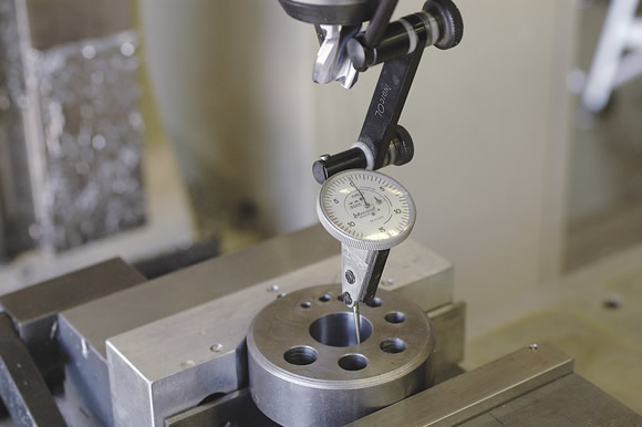

  • Get an indicator with a vertical dial. This beats craning your neck like a bird hunting a worm all around the mill when zeroing a part.

Using an indicator with a vertical dial beats craning your neck when zeroing a part. All images courtesy T. Lipton.

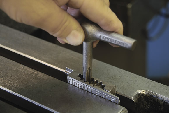

  • Prior to discovering special-toothed wedges, I used 5/8 " dowel pins as backstops in the mill like everybody else. But the wedges fit tightly in a T-slot of any width. You can easily vary the height and even use them for special clamping jobs.
Special-toothed wedges are effective as backstops in a mill.
