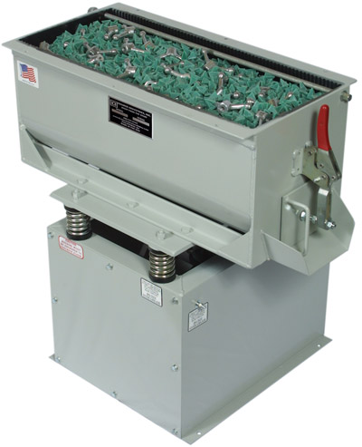

DB300 vibratory tumbler by Kramer Industries
The DB300 vibratory tumbler by Kramer Industries. DB tub vibrators are designed as starter machines for novices or shops on a limited budget.
