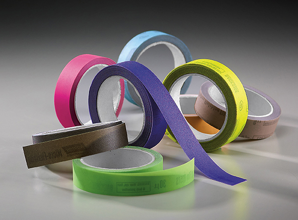

Norton Finium microfinishing films use a proprietary resin system to hold grains in place for finishing in automotive engine applications. The film-backed ultrafine grit abrasives come in a range of shapes, sizes and grits to fit a wide variety of requirements and eliminate the concern of grain fallout, which could leave coarse scratches and result in defective parts.

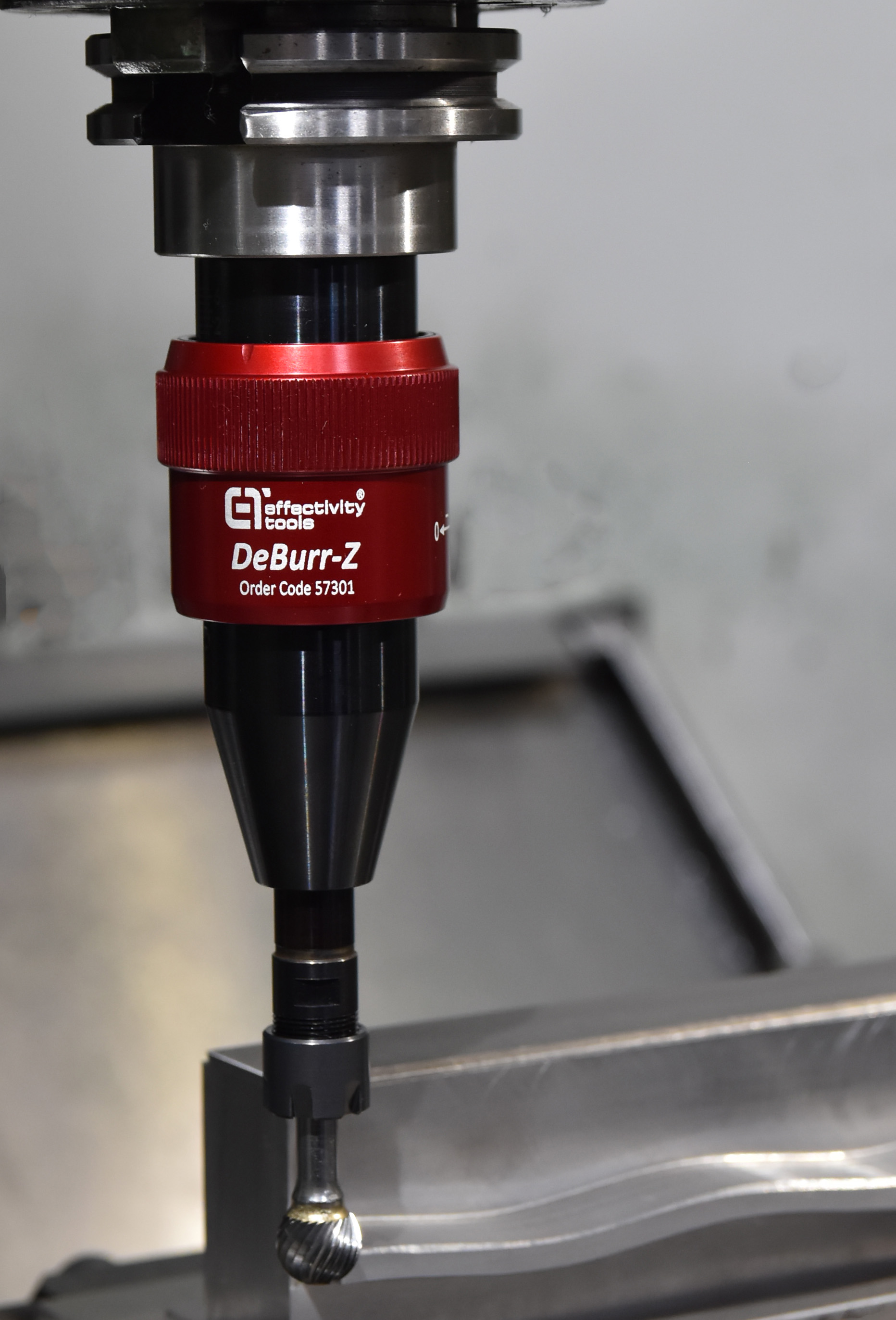

DeBurr-Z follows the outer contours of the component with an adjustable force accommodating the type of material and the desired edge break.
DeBurr-Z follows the outer contours of the component with an adjustable force accommodating the type of material and the desired edge break. Image courtesy of Tapmatic
Used to finish the surface of many automotive components — including camshaft lobes and journals; crankshaft mains, pins, thrust walls and oil seals; and transmission shafts — Norton Finium is wound onto a roll that varies in length depending on the machine being used. The width of the film depends on the part being polished. A user places the film over polishing shoes attached to polishing arms while the part is secured in a fixture and the polishing arms are clamped around the part. The array keeps contact with the part and Norton Finium for a given amount of time, generating the desired finish.
"Polishing is a rubbing or abrasion process where the cutting fluid (mineral seal oil or polishing oil), the Finium abrasive and resin from the bond form a flurry, and that's what's doing the finishing," Goetz said. "Typically, we're only taking off between 3 and 5 μm when we're lapping. By polishing, you get a better surface condition and the engine runs more true. In turn, it cuts down on the vibration and noise and adds to the life of the product."

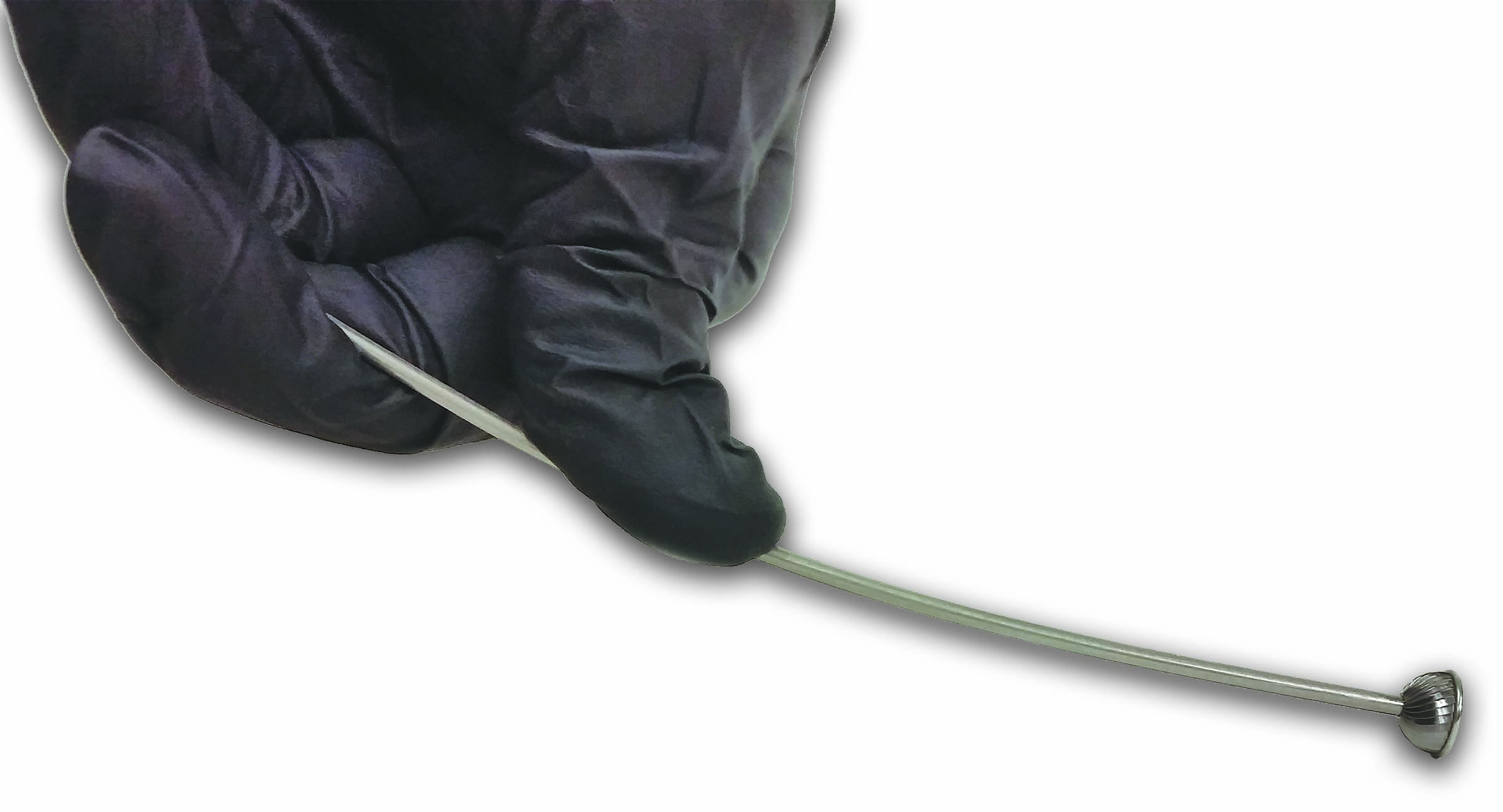

Orbitool's flexible shaft allows a user to bend and pre-load the tool.
Orbitool's flexible shaft allows a user to bend and pre-load the tool. Image courtesy of J.W. Done

The cutting method is fairly traditional using a carbide rotary burr, but Orbitool features the combination of a flexible drive shaft made of tool steel, a carbide shaped cutter and a polished steel disk. This commonly is referred to as a lollipop cutter. The larger-diameter polished disk negates the risk of damage to a part.
"The flexible shaft allows us to bend and pre-load the tool," Kroll said. "We have a protective ring to place against the wall, bend the shaft slightly and pre-load the cutting tool. The toolpath uses helical interpolation, otherwise known as a thread spiral or helix spiral. With the Orbitool, the operator doesn't have to program any complex contours or even know precisely where their edge is or its precise shape. We pre-load the tool and place the helix spiral where deburring is needed. It's the tool's ability to self-select and constantly bend and flex to the environment around it that allows it to deal with an interrupted cut. It only cuts material in the area where you need deburring but won't damage anywhere else."
Other deburring tools exist to help with the top and underside edges. Tapmatic Corp. in Post Falls, Idaho, created DeBurr-Z, which works on a CNC machine for both compression and extension, allowing the cutting tool to follow the outer contours of the component. With an adjustable force, the pressure may be increased or decreased to accommodate the type of material and the desired edge break.
Norton Finium films can be custom-cut to meet customer-specific width and length requirements, core dimensions and edge designs.
Norton Finium films can be custom-cut to meet customer-specific width and length requirements, core dimensions and edge designs. Image courtesy of Norton | Saint-Gobain Abrasives
Chamfering holes on a curved surface also presents problems for conventional deburring methods. Using a standard countersink tool results in inconsistent edge breaks. Going around the holes with the axially floating DeBurr-Z produces consistent results, said President Mark Johnson. In general, either angular- or spherical-shaped burr cutting tools are used to apply the right contact to the workpiece for chamfering or deburring the edge.
"The edges of the workpiece can often be a little difficult to identify or clearly define like in the case of castings, cross-holes or slots," he said. "It can be difficult to follow the edges evenly, but a floating tool has the compensation that lets the burr cutting tool follow the edge even when its position varies."
