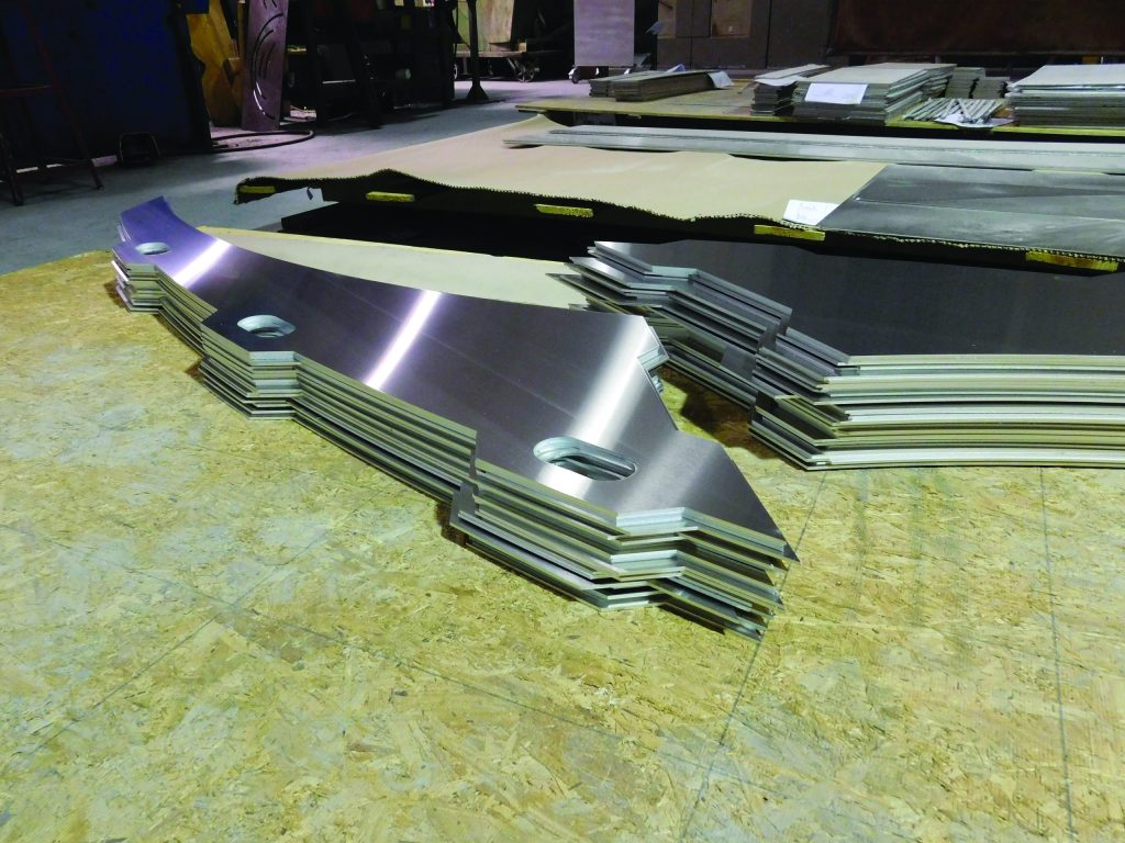

Ornamental and architectural metal products, signage and artwork, as well as sheet-metal products like wall panels, corner trims, and ceiling inserts are counted among TCI's diverse range of fabrication capabilities. Sheet metal parts, weldments, structural steel, pressure vessels, and unique metal finishes are typical projects that make their way across the shop floor. Aluminum, carbon steel, stainless steel, brass, and copper are TCI's most commonly used materials.

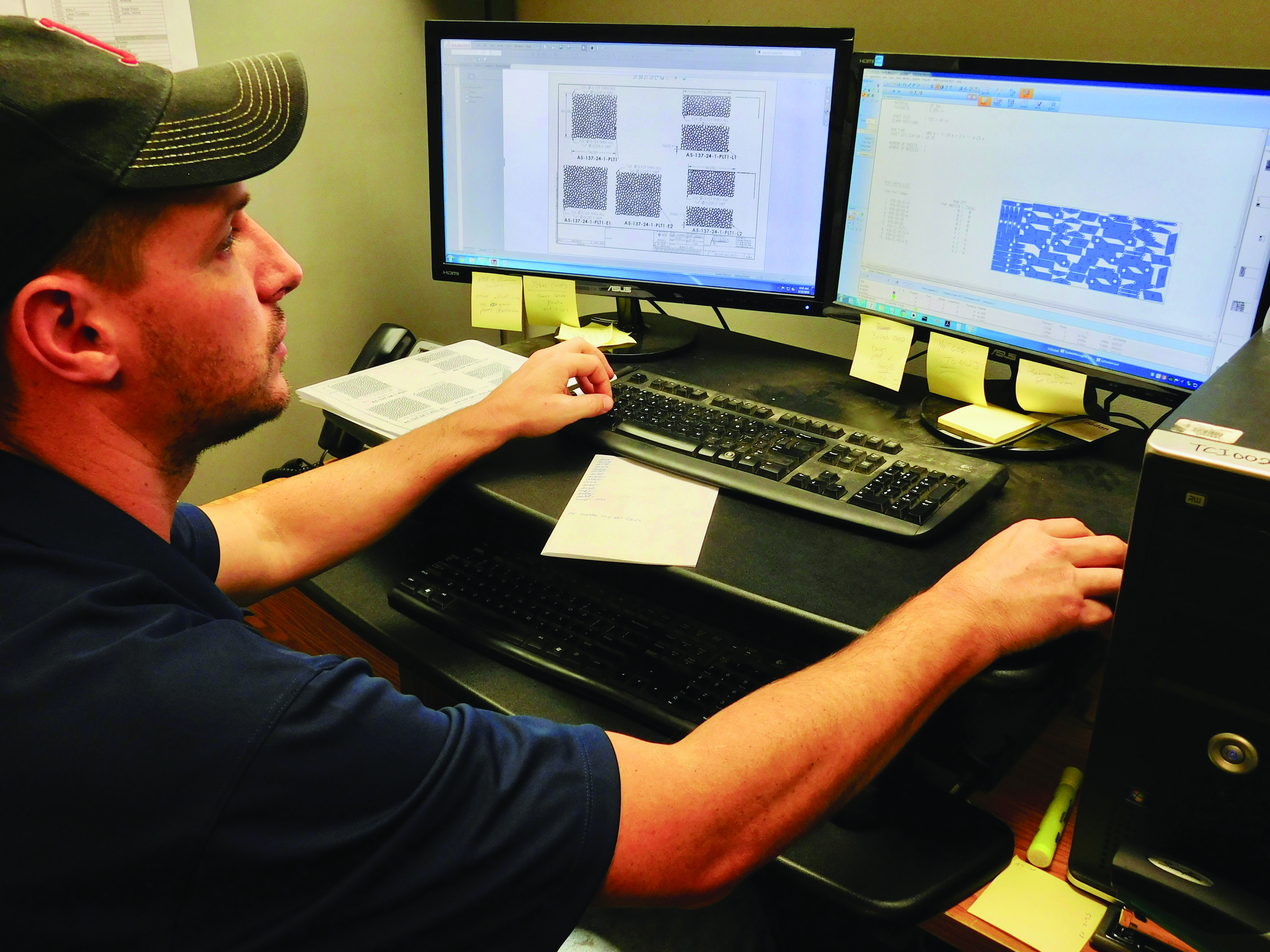

Prior to the implementation of RADAN, staff at TCI would begin the nesting process and then tackle other shop tasks while the nests were generated, as the process typically took hours to complete.
"RADAN can make a day's worth of nests in a couple of minutes," McGinnis says. "This is a huge difference to us in man hours alone. "
He said that the company has one employee who programs for half the day and spends the rest of the day working on engineering projects. "Because of what we're able to do with RADAN, it's not necessary to have a person generating nests full time anymore."
Unlike many other solutions for sheet metal, RADAN also allows editing of its automatically-generated nests, ensuring that programming control remains in the hands of the user.
"The ability to edit nests was something that our old software could not give us, and we can do that with RADAN— edit the lead in lead, lead out, tooling, or just edit for cosmetic reasons," McGinnis said. "That was another high point for RADAN."
