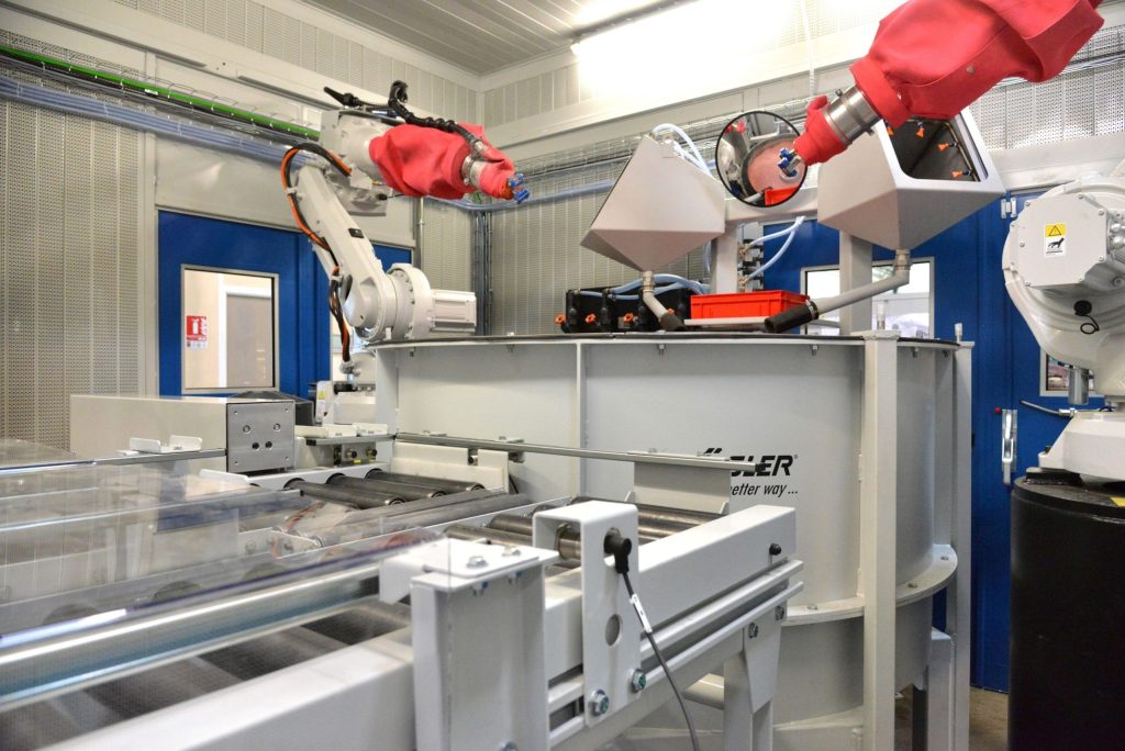

A New Dimension of Barrel Finishing
Various developments such as drag finishing and so-called surf, or stream, finishing make reliable and economical lot processing by means of barrel finishing possible for parts which are sensitive to damage and could previously only be deburred, ground, polished or smoothed by means of a costly, nonreproducible manual procedure or at great expense with the help of a machine.
In the case of drag finishing, the parts are clamped to workpiece carriers which are then dragged through a barrel with abrasive particles or a polishing medium. Uniform flow of the abrasive particles or polishing medium around all sides of the workpieces results in effective but nevertheless gentle processing. Even in the case of workpieces with complex geometries, ideal, reproducible processing results of “handmade quality” can be achieved within a relatively short period of time.
Surf finishing goes one step further. A robot immerses the workpiece at a precisely defined position into the rotating bowl which is filled with grinding medium, and accurately guides it. This makes it possible to selectively process certain areas, or different radii can be achieved by variously positioning the robot arm. High grinding pressure is generated by rotating the bowl while the component is surfing in the grinding medium. This results in intensive, reliable processing with short cycle times and a surface finish which complies with the specified requirement.
