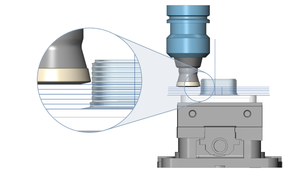

With the new feature for creating generic revolved tools, operators can customize the shape of the cutting and non-cutting parts of the tool for all triangle mesh-based roughing strategies. Customized tools avoid over-simplifications because they take specific features of the tool shape into account during the toolpath calculation to deliver a realistic simulation of the material removal process.

Custom tool shape for roughing
