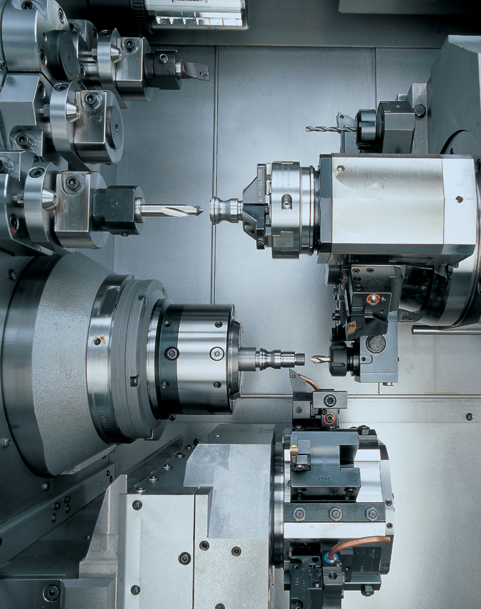

The dynamic new generation of the ABC machine from INDEX is ideal for turning out simple to moderately complex parts in cycle times up to 15% faster than the previous generation with rapid spindle acceleration (8 g), shorter spindle ramp-up times, higher rapid traverse rates, and quick chip to chip times, according to the company. Ideal for runs from 5,000 to 50,000 parts in the 42 to 60 mm range, the machine's combination of features supports a low production cost per piece, even for complex parts.
The dynamic new generation of the ABC machine from INDEX is ideal for turning out simple to moderately complex parts in cycle times up to 15% faster than the previous generation with rapid spindle acceleration (8 g), shorter spindle ramp-up times, higher rapid traverse rates, and quick chip to chip times, according to the company. Ideal for runs from 5,000 to 50,000 parts in the 42 to 60 mm range, the machine's combination of features supports a low production cost per piece, even for complex parts. Up to 19 tools are available for highly flexible machining with live tools for both turrets.
Extremely short cycle times are achievable due to simultaneous machining with up to three tools. The ABC is equipped with up to five driven back-working tools and offers driven tools in all turret positions. The machine is available in 2-, 3- or 4-axis versions. The motorized 27-kW, 6000-rpm spindle, can generate up to 95Nm of torque.
Within the easy-access work area, mounted above the main spindle, is the upper turret used mainly for ID work. The lower turret is typically for OD work. A synchronized spindle operates in the upper turret. Both turrets feature a rapid traverse of 36 m/min.
The ABC can handle heavy-duty polygon turning and thread milling with a counterspindle or drive attachment. The ABC can also be supplied with a quiet-running Index bar loader which can save 4 to 30 seconds per cycle, and automatic part unloader automation.
