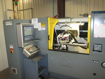

The CNC retrofit package content depends on the configuration of the hob sharpener. Basic SNC 30 machines have two CNC axes as standard, one (X) for the wheelhead slide and the other (A) for the workpiece spindle, and can be fitted with a further two optional axes to automate axial (Y) and radial (Z) movement of the wheelhead. At a customer's request, North East Technologies will incorporate these extra axes during the retrofit process. In addition to upgrading the machine's controller to a NUM Flexium 68 CNC system, the retrofit replaces all motors and drives with high performance NUM servomotors and NUMDrive C servo drives. The new servomotors are equipped with high resolution 262,000 pulse/rev encoders, the original motor encoders were 1,000 pulse/rev devices, which in conjunction with the powerful Flexium CNC kernel provide much more accurate control of speed and position.
Considerable attention has been paid to ensuring that the HMI of the CNC retrofit preserves the familiar "look and feel" of the original SNC 30 operating system. A "fill in the blanks" programming method, backed by custom control macros, means that the machine operator is not presented with unfamiliar CNC nomenclature, and simply enters parameters such as the length of flute and the amount of material to be removed. Each screen is context-sensitive to eliminate ambiguity. For example, selecting a grinding cycle that uses a CBN (cubic boron nitride) wheel opens a folder that only contains options for CDG (conventional deep grinding) and SDG (single flute deep grinding), with dressing disabled. The software also allows the operator to "teach" the machine the relative positions of the X,Y, Z and A axes under manual control, enabling grinding cycles for different hobs to be developed very easily.
To maximize flexibility, the application accommodates multiple hob sharpening methods, including removal of stock in one or both directions of wheelhead traverse. For straight fluted hobs, as soon as one flute has been sharpened the workpiece is indexed through to the next flute and sharpening recommences. Utilizing the Flexium CNC system's "Dynamic Operator" (DynOp) function, the machine builder can create custom axes linkage or compensation in real time, at the position loop clock cycle. In the case of sharpening helically fluted hobs, this unique DynOp feature allows the rotary (A) axis to be transparently synchronized to the X axis, so the grinding wheel accurately follows the helix angle.
North East Technologies' CNC retrofit provides gear manufacturers with considerable long-term benefits, as Harry Salverston points out, "Our first SNC 30 upgrade project using the new NUM package involved retrofitting a two-axis machine, in 2011. This has operated without problems ever since and has enabled our customer to improve the quality of their gear sharpening process substantially by more than doubling its accuracy, as well as increasing throughput by about 40 percent. Together with NUM, we have further developed the CNC retrofit package and following recent orders are currently rebuilding three machines, including a two- to four-axis conversion."
