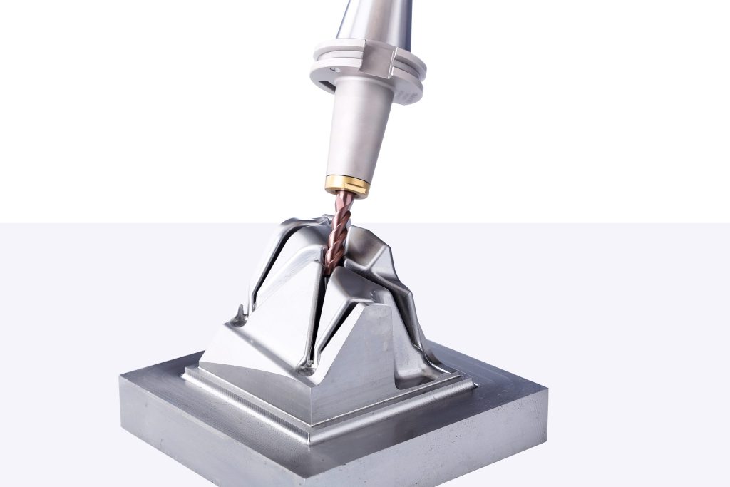

Diebold JetSleeve 2.0 technology offers a unique coolant supply system that is unmatched by any other tool holder product. The JetSleeve 2.0 patented design not only delivers coolant to the cutting edges of your cutting tools, but it also it accelerates the coolant multiple times over the "normal" machine coolant pressure to blast the chips/swarf away for the machined surfaces to eliminate recutting of chips that leads to shorter tool life and prevents smooth machined surfaces.
The Jet Sleeve 2.0 technology offers a "Gold Ring" Nozzle at the end of the Diebold shrink fit holders. This nozzle has tiny holes and varying angles that not only "twist" the coolant as it enters the "vortex" but these holes cause the coolant pressure to increase and create a strong coolant flow that blasts all chip away from the cutting tool path and cavity if you are machining down into a part. This is a great application for high production setups for machining high-nickel material, die mold materials, medical parts, and aerospace parts.
