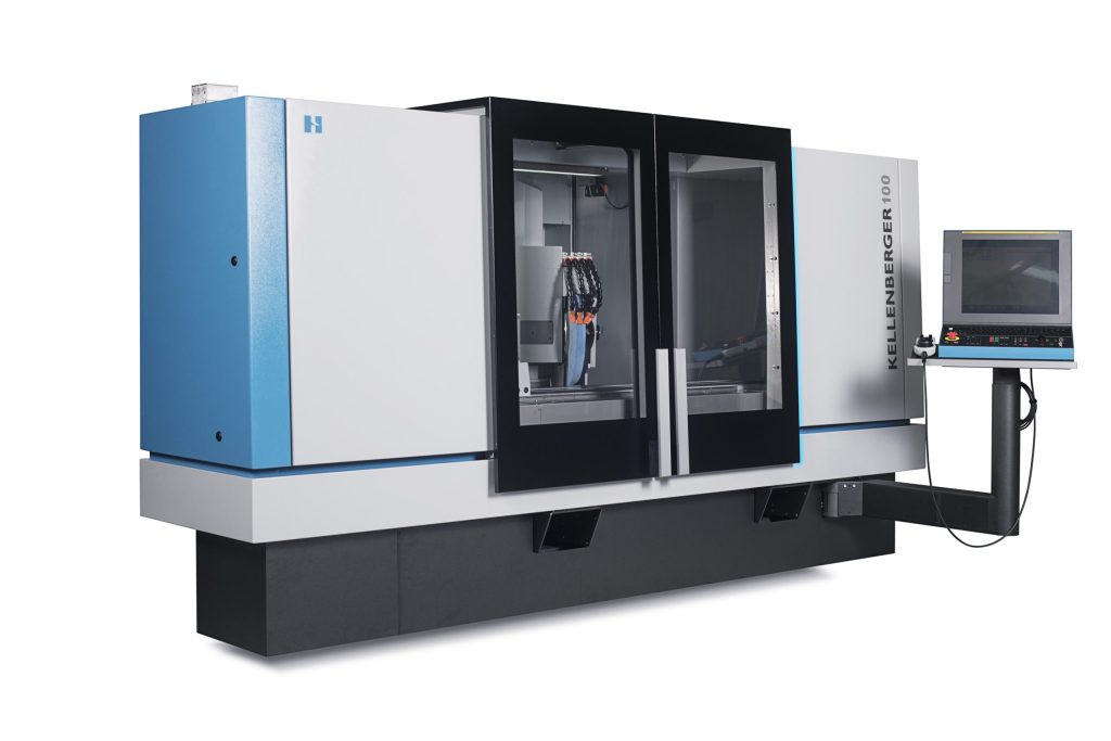

Hardinge Inc. introduces the new Kellenberger 100 (pictured) and Kellenberger 1000 Universal CNC grinding systems. These innovative systems improve the precision and productivity for the most demanding range of machining applications. The updated functional and user friendly design elements on both of these systems allow you to have the control and performance you require.
"These systems were made to satisfy the requirements of our customers. We took their feedback and from the rigid base to the hydrostatic guides on all axis, all the way to the new user interface on our controls we delivered two systems that will meet the most demanding of those requirements, and if Industry 4.0 is an important topic for you these machines are equipped with OPC UA communication gateways for secure external access, the machines are well prepared for the future." Helmut Gaisberger, global product manager grinding.
The Kellenberger 100 is a new high-performance, economical grinder for any of universal grinding requirements. The machine is the combination of capabilities that are found in the VISTA and VITA machines, as well as the Tschudin T25, and the Jones & Shipman Ultramat CNC and Ultragrind 1000. It delivers a diverse of configuration options for a range of grinding operations for customers looking to optimize production costs for the machine and ensure an excellent price/performance ratio.

New compact wheelhead design - The Kellenberger 100 has a new tandem grinding wheelhead in compact and collision free construction with the motor spindle. Reinforced casing for larger grinding wheel diameters for internal grinding. Choice of 10 wheelhead variations for the optimal layout of the machine based on the components to be processed.
Increased productivity with higher grinding wheel drive power.
Enhancing performance o Realize new dressing concept by extended travel of X and Z axes
Greater Profile Accuracy with Redesigned Z-guideways.
High precision B-axis with direct drive and absolute measuring system
Increased accuracy for noncircular grinding with C-axis with direct drive.
The user-friendly and ergonomic design of the Kellenberger 100 machines with a new, intuitive operator guidance system on a touchscreen panel. The machines are equipped with the latest FANUC 31i CNC with 19" touchscreen, The User Interface is available in two different versions: BLUE Solution - the intuitive touch programming and RED Solution - the extended graphic programming.
