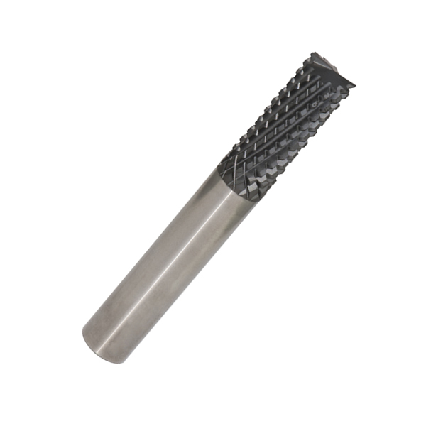

First of the expansions comes with significant additions to several series of DFC routers. "With these series, we focused on designing these tools as if they were a family," saidJennifer Neubauer, LMT Onsrud product manager. "When you spec in a tool for roughing, or finishing, or even semifinishing, we've found that leveraging products with similar design characteristics helps deliver a better overall piece-part quality as a whole."
The new 66 Series lineup stacks up as follows:
  • 66-500 The Multi-Purpose Rougher/Semi-Finisher
  • 66-700 The Finisher
  • 66-750 The Semi-Finisher
  • 66-775 The Rougher
  • 66-800 The All-Around Router
In addition to the above series, LMT Onsrud has also added more than 100 SKUs to its MaxQ line of solid-carbide endmills. Designed to maximize machine performance while being run at maximum speed and feed rates, the MaxQ offering now includes an increased offering of 5-flute endmills in various corner radii including ballnose tools. The MaxQ endmill line comes in 4- and 5-flute configurations and includes Weldon-style offerings as well. The augmentation to the line brings the total number of products under the MaxQ umbrella to more than 600.
In addition, the 68-500 Series PCD engravers are designed with extreme tool life in mind. These engravers are available with an included angle of 60 degrees and in three tip diameters (0.010 mm, 0.020 mm, 0.030 mm) and can be used to engrave within very abrasive materials.
