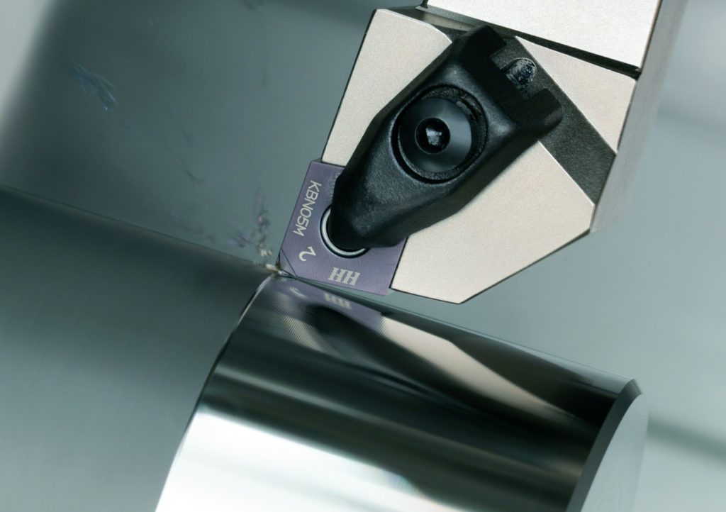

PCBN Inserts with HH Chipbreaker
Kyocera Precision Tools introduces new economical double-sided, multiple-edge PCBN inserts with HH chipbreaker for machining hardened material with excellent chip control. These PCBN inserts are design for optimized small DOC finishing for workpieces that are 55 HRC or harder.
The HH chipbreaker inserts come in KBN05M insert grade designed with a hybrid grain structure with high-hardness, high-strength MEGACOAT coating technology to ensure longer tool life with superior oxidation and wear resistance.
