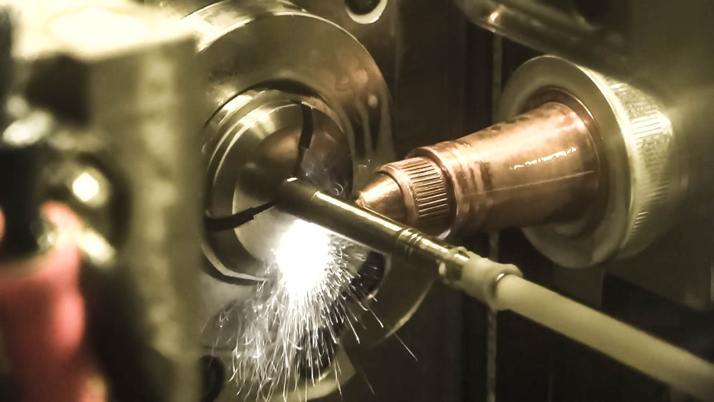

Tsugami LaserSwiss offers a new LaserSwiss CNC machine tool. The new LaserSwiss is a next-generation Precision Tsugami B0125-III. The 12 mm, 5-axis Swiss-style CNC lathe features a fully integrated SPI laser cutting system.
“We don’t know of anyone else offering a 12 mm machine that combines Swiss turning and laser cutting within a fully integrated operating platform,” Tsugami LaserSwiss Business Development Director Dan Walker said.
All laser operations are programmed and driven from the machine’s FANUC 0i-TF control and the laser’s power, pulse width, frequency, lens focus and nozzle standoff are on-the-fly adjustable. The machine is equipped with a gas box capable of switching between two assist gases, which are typically nitrogen, oxygen and argon.
The machine has 10 tool positions in addition to the laser and it is convertible, meaning it can be run as a traditional Swiss style lathe using a guide bushing or operated with an optional chucker kit, which can be installed in minutes.
“This machine offers tremendous flexibility,” Walker said, “but it’s not overly complicated. It’s a straightforward, simple machine that’s very easy to program and use.” Of the nine Tsugami LaserSwiss machines on the market, the B0125 is the most affordable, he added, and its small footprint of roughly 20 square feet makes it suitable for shops with limited floor space.
Customers can order Tsugami LaserSwiss machines with laser watts ranging from 200W to 500W, depending on their preference and model selection. The SPI laser units are rated to last 500,000 hours without service. “It’s like having a very fast, very precise cutting tool that never gets dull,” Walker said.
