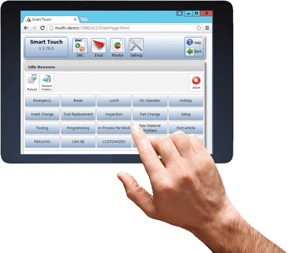

Spectrum CNC Technologies announced the release of SmartTouch; the intelligent interface provides machine operators with easy touch screen access to Multi-DNC files and serves as a feedback loop for job status information. Operators can report parts counts, downtime reasons and much more. Customizable "one-touch" buttons make feedback fast and easy.
SmartTouch supports both Multi-DNC and machine monitoring applications on the shop floor. Based on a rugged shop-tested touch screen, the SmartTouch can be configured to support individual job status feedback from operators as well as electronic parts counts. All shop floor DNC files and functions as well as customized monitoring feedback are accessed through SmartTouch.
SmartTouch serves as a shop floor interface for Multi-DNC Software, providing machine communications and control. Multi-DNC software, coupled with state-of-the-art communication hardware networks CNC machines and robots. It supports CNC communications for uploading, downloading and dripfeeding. Multi-DNC manages CNC programs, offsets, parameters and can automatically capture probe data. The software includes a secure edit function, backplotter and file compare features.
SmartTouch serves as an operator feedback interface for Multi-MDC Machine Monitoring, a browser based real-time machine monitoring system that automatically collects machine output data to an MS-SQL database. Real time dashboards and production reports display shop floor manufacturing data including OEE, cycle, alarm, spindle, tool usage, idle, setup, teardown, machine downtime and more. SmartTouch provides easy one-touch Reasons feedback for associated machine status reporting. Reasons feedback buttons can be customized to individual shop processes.
