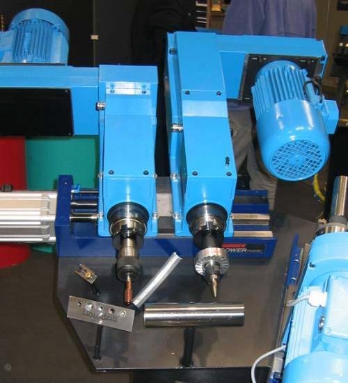

Suhner can offer for this work a range of drilling units with various feeding systems. The classical flow drilling units are the BEM 12 and the BEM 20, each with pneumohydraulic feed, i.e. a pneumatic feed regulated with a hydraulic cushioning cylinder. Pictured is a typical application where after flow drilling with the machining unit BEM 20, the thread is formed with the GEM 20 unit.
The following series of operations are implemented in practice.
1. The spindle moves the rotating flow drill in rapid traverse directly in front of the workpiece.
2. Now under regulated, but still rapid feed, the tool tip contacts the workpiece.
3. Under the action of friction, the material glows and starts to flow.
4. The feed movement, first obstructed by the contact, now continues, i.e. the spindle presses the flow drill through
the material. The characteristic collar is formed.
With this method, the flow process defines the spindle's feed movement.
