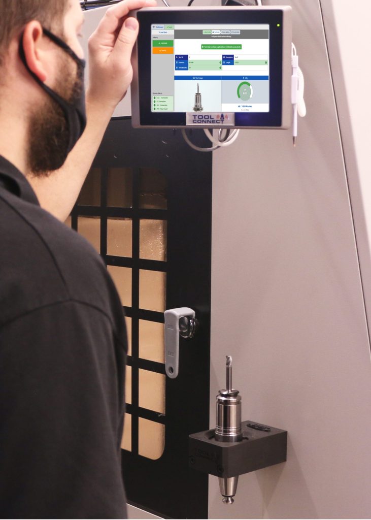

This system uses a customized RFID read station and an intuitive interface tailored to the user's tool load and unload process. The ToolConnect HMI displays all user-specified tool and process info, along with a tool image to easily verify that the correct tool is being loaded. The system can automatically index to the correct magazine position for further error-proofing of the process on some machine tools.n

Caron Engineering offers a retrofit tool identification and data management (ToolConnect) system that automatically reads and writes tool presetter data between the machine control and RFID tags embedded in tool holders.
