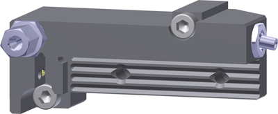

FLP Tooling distributes the new Applitec Modu-Line holders designed specifically for the Tornos ST26 machine: the ML16-SWISS-ST26 and ML16-SWISS-ST26-JET. Both holders, boasting 16x16mm tool geometries, have a compact and rigid construction well adapted for the cutting conditions present on the ST26.
The holders can be used on both gang 1 and gang 2 operations. And, with the JET holder's cooling system, high pressure coolant (up to 100 bars) can be administered to the cooling tip.
