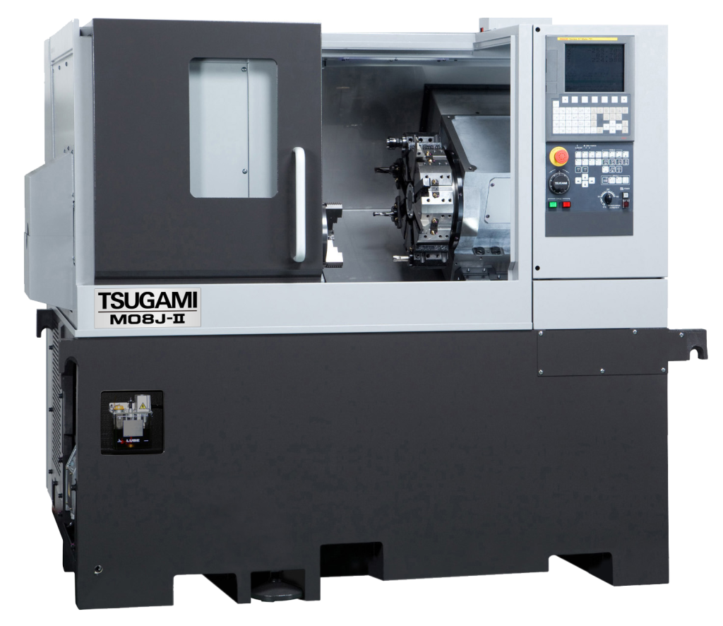

Tsugami/Rem Sales LLC announced its newest machine offering; the Tsugami M08J, a 2-axis turning center with a manual tailstock, programmable quill and A2-6 spindle nose.
“The addition of the Tsugami M08J to the Rem Sales Universal Product Line offers the increased options and flexibility that we pride ourselves on,” explained Michael Mugno, vice president, Tsugami/Rem Sales. “The M08J is undeniably the most rigid 2-axis lathe in its class and is a great fit for most every machine shop.”
The Tsugami M08J CNC lathe features a rigid construction using boxed ways for the X-axis with oversized linear guides for the Z-axis for heavy-duty machining. Thermal displacement compensation comes standard on the M08J, which allows for the highest level of machine accuracy by measuring the thermal displacement using the touch sensors installed on the X-axis slide. All of this is packed into a conveniently small footprint - 67 inches x 66 inches x 63 inches.
The Tsugami M08J is suitable for a number of applications, such as turning, drilling, boring and thread cutting.
Options for the Tsugami M08J include the addition of high pressure coolant, foot pedals and a chip conveyor.
Overview of the Tsugami M08J:
  • 8” chuck
  • 8-station automatic turret
  • Manual adjust tailstock
  • Programmable quill
  • Part catcher with conveyor
  • Box way for X-axis slide
  • Roller guide for Z-axis slide
  • 7,275-lb. massive construction
  • FANUC 0i-TF control
Included Features:
  • 3-jaw hollow 8” chuck
  • Parts catcher with conveyor
  • Work stopper
  • Tailstock with live center
  • Through turret flood coolant
  • Thermal Compensation
