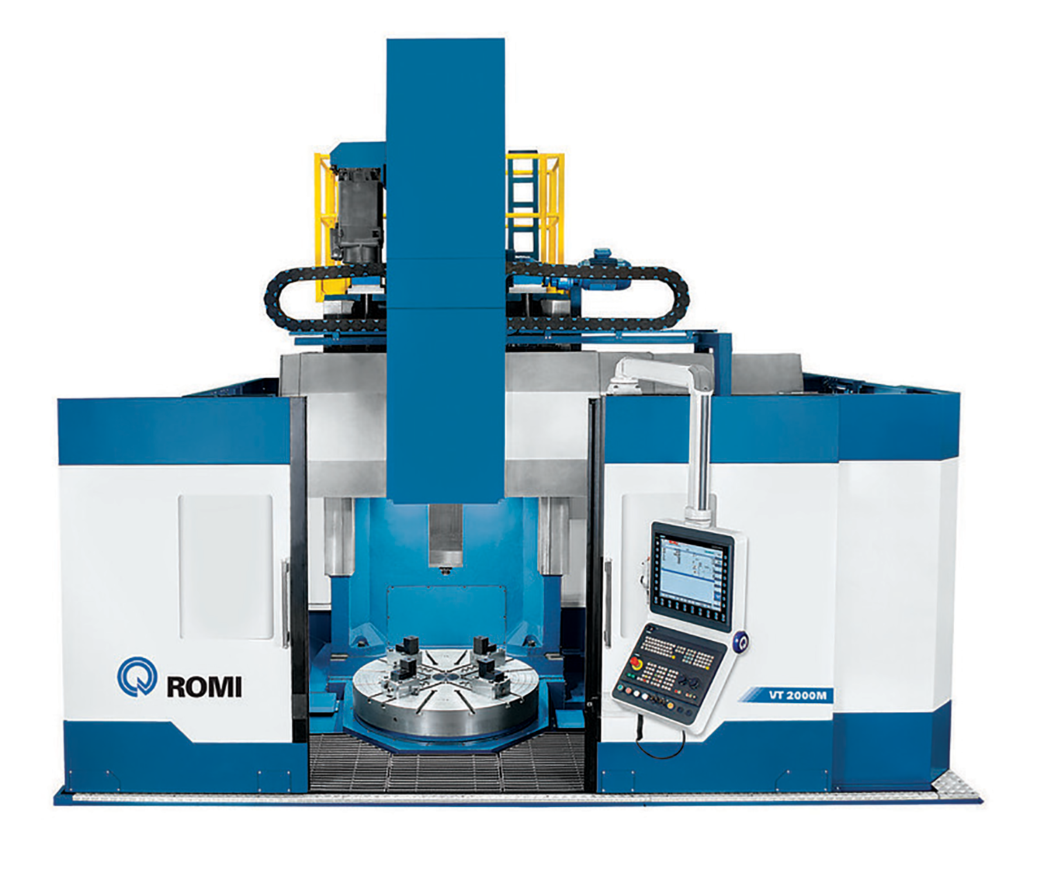

The series includes the VT 1400M, VT 2000M, VT 2500M, VT 3000M, VT 5000 and VT 6000 with table sizes from 1,400 (55") to 6,000mm (236) with maximum turning diameter from 1,600mm (63") up to 7,000mm (276") and maximum height allowed from 1,650 (65") to 4,000mm (157").
Romi's VT Series Vertical CNC Lathes includes six models ranging from the VT 1400M with a load capacity of 22,000 lbs. to the massive VT 6000 that will handle 198,400 lbs. on chuck. The ability to effectively machine parts this size are made possible in large part to Romi's cast iron monoblock beds, columns and vertical carriage. The robust mechanical structure provides exceptional rigidity, stability and versatility for machining workpieces found in heavy industry.
All models feature vertical RAM, C axis, 31kW live tooling with spindle taper ISO 50 with either a 10 or 20 tool magazine, and linear scales for machining precision. The VT Series are equipped with a Siemens Sinumerik 840D SL CNC with a large 19" LCD color monitor, USB port and Ethernet interface.
