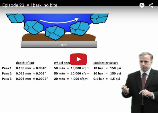

Dr. Jeffrey Badger, the host of Cutting Tool Engineering magazine's Grinding Doc Video Series, fields a question from a shop taking smaller and smaller finishing passes and several spark-out passes in order to get tight tolerances and a good surface finish. But the shop is having trouble getting the wheel to bite into the workpiece. All it does is ride over the top, and the shop is using high-pressure oil. How can the shop get the wheel to bite? The Grinding Doc responds in this 23rd episode of the video series.
