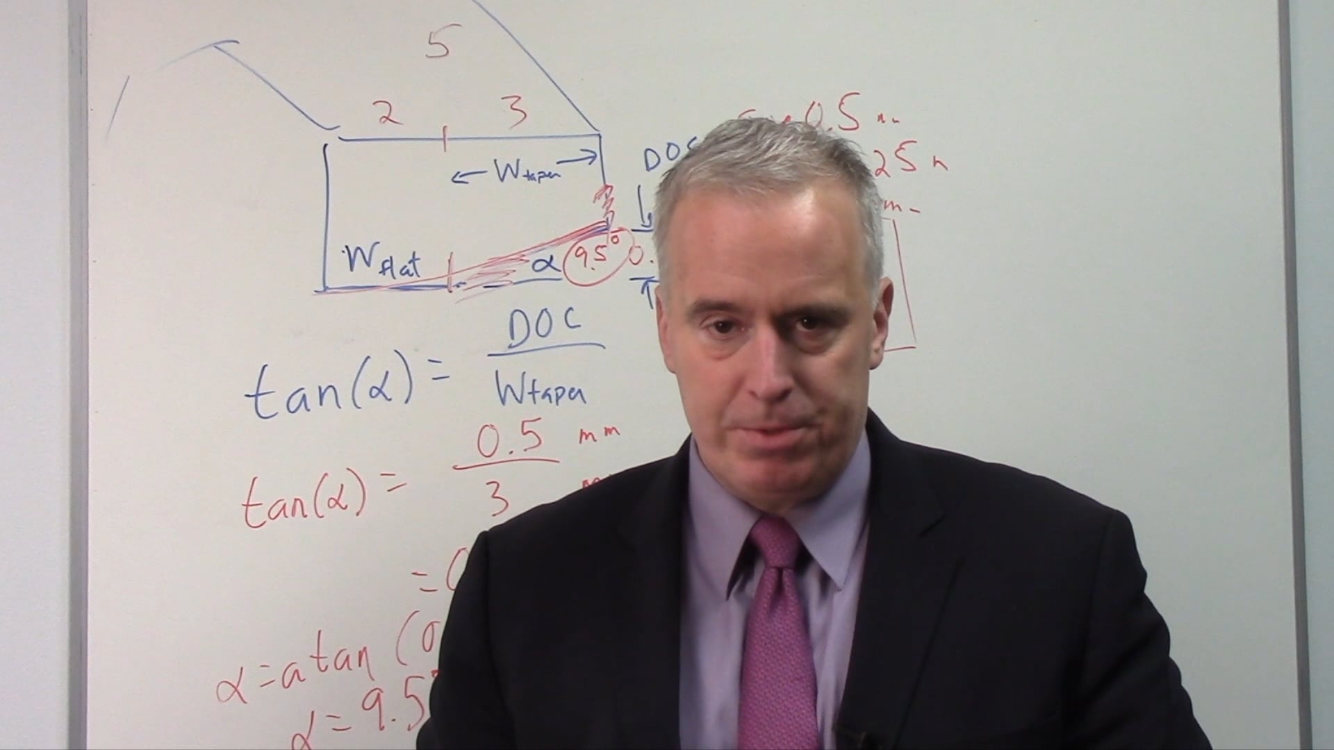

For the 86th episode in the Grinding Doc video series from Cutting Tool Engineering, Dr. Jeffrey Badger encourages shops to true a taper in the wheel when they perform cup wheel grinding.
