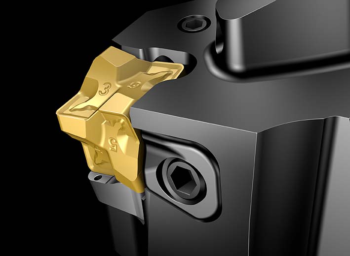

High-pressure coolant (HPC) isn't a gimmick. It's been proven to greatly extend tool life and dramatically boost productivity. That's because HPC is extremely effective at removing heat from the cutting zone. The result is that cutting parameters can, and should, be increased to generate sufficient heat for the metal-removal process to function properly. On the surface, this may seem counterintuitive—why eliminate heat just to create more? But when you consider that cutting speeds with HPC are often five times that of conventional flood coolant, it's a no-brainer.
High-pressure coolant is extremely effective at removing heat from the cutting zone.
The Sandvik Coromant CoroTurn 300 (shown) is ported to supply high-pressure cutting fluid directly
above and below the cutting zone.
All images courtesy of Sandvik Coromant.
If your shop lacks the funds for an HPC system, don't despair. Surprising gains are still there for the taking if the cutting fluid—even applied at low pressure—is properly directed. A number of cutting tool providers have recognized this and are producing tool bodies, or holders, with integrated cutting fluid ports. These holders can be ported to supply cutting fluid directly above and below the cutting zone, dramatically reducing heat. Goodbye, plastic hoses and copper lines!

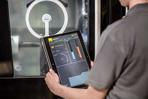

What's your documentation strategy? If you're still scribbling things down on tool setup sheets, it's time to get digital. Shops of all sizes can afford to scatter a handful of PC workstations or tablets across the production floor, if not placing one at each machine.
Job "diary" templates should be established to keep track of events, and employees should be encouraged to use them. Doing so helps eliminate the risk of tribal-knowledge loss the next time a top employee moves on.
across the production floor, if not one at each machine, to enable proper documentation.
Even for those shops that haven't taken the step of implementing a centralized tool-management database, apps that calculate productivity, provide educational materials, identify inserts and perform other functions are available to help make a machinist's life easier. And making cloud-based tool libraries available streamlines setup and programming operations, and gives machinists ready access to application information.
