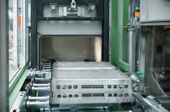

Modular cleaning systems, which can be integrated into a parts production line, offer flexibility. In this example, diesel injection system parts are transferred from a cleaning chamber to a vacuum dryer.
The workpieces are mechanically cleaned, such as via spinning or vacuum blasting, during the first step, which removes some of the metalworking fluid. The second step involves immersion flooding, where water is injected at 145 to 220 psi into the cleaning chamber below the surface of the bath. The resulting whirlpool rinses chips and contamination out of hollow spaces, such as threaded blind-holes. Waterjets aimed at openings in the component and lances advanced into holes quickly optimize results. Lances allow users to inject cleaning fluid at a high pressure into drilled holes and remove contaminants while also deburring. A drying process then follows rinsing.
The growing number of engine and gearbox variations, as well as ever-shorter product life cycles, requires significant cleaning system flexibility—even for individual part cleaning operations. This can be accomplished with robotic cleaning systems, which are integrated into production lines. Thanks to simple reprogramming options, these systems assure levels of flexibility comparable to those offered by machining centers.
Large numbers of vehicle parts can be cleaned at the same time in batch processes. Single- and multiple-chamber systems, which can be integrated into the production line, are also available for these batch cleaning tasks.

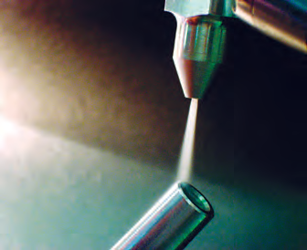

Cleanliness requirements for a single workpiece can vary greatly. For example, the requirements for functional surfaces like sealing, joining, bonding and laser welding areas are often stringent to guarantee an effective and durable connection is achieved. In such cases, cleaning targeted at specific component surfaces may be advantageous. That’s because it is often considered too costly to conventionally clean with aqueous media or solvents to achieve the same high degree of cleanliness for the entire part that’s specified just for the functional surface.
Bantleon_VCI--Produkte.tif
Courtesy of Hermann Bantleon

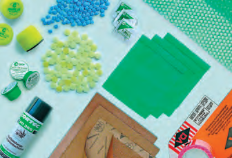

VCI materials, which consist of powders, granules, liquids, impregnated foils, foams or paper, create a gas phase inside a closed package and protect against corrosion.
In the face of increasing cost pressures for automotive suppliers, functional surface cleaning—such as using CO2 snow jet, laser or plasma processes—can save time and money. A further advantage of functional surface cleaning when integrated into the production process is that the cleaned surface is available just-in-time, thus eliminating any need to maintain cleanliness after cleaning and during transport.

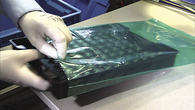

As soon as functionally critical parts leave the cleaning system, however, there is a danger of recontamination. To prevent contamination with particles from the environment, it may be necessary to inspect, package and store them in a so-called “clean zone,” and to provide the personnel there with appropriate clothing and gloves.
In the automotive industry, functionally critical cleaned components are transported and stored in appropriate packaging. These frequently consist of so-called “VCI (volatile corrosion inhibitor) foils,” which also offer corrosion protection. Part-specific, reusable, deep-drawn, plastic sheet materials are also used to protect cleaned parts, as are small plastic boxes that usually hold small parts. In addition, these boxes are often lined with foil. To avoid recontamination of the cleaned parts caused by this packaging, they also have to be cleaned at regular intervals. CTE
