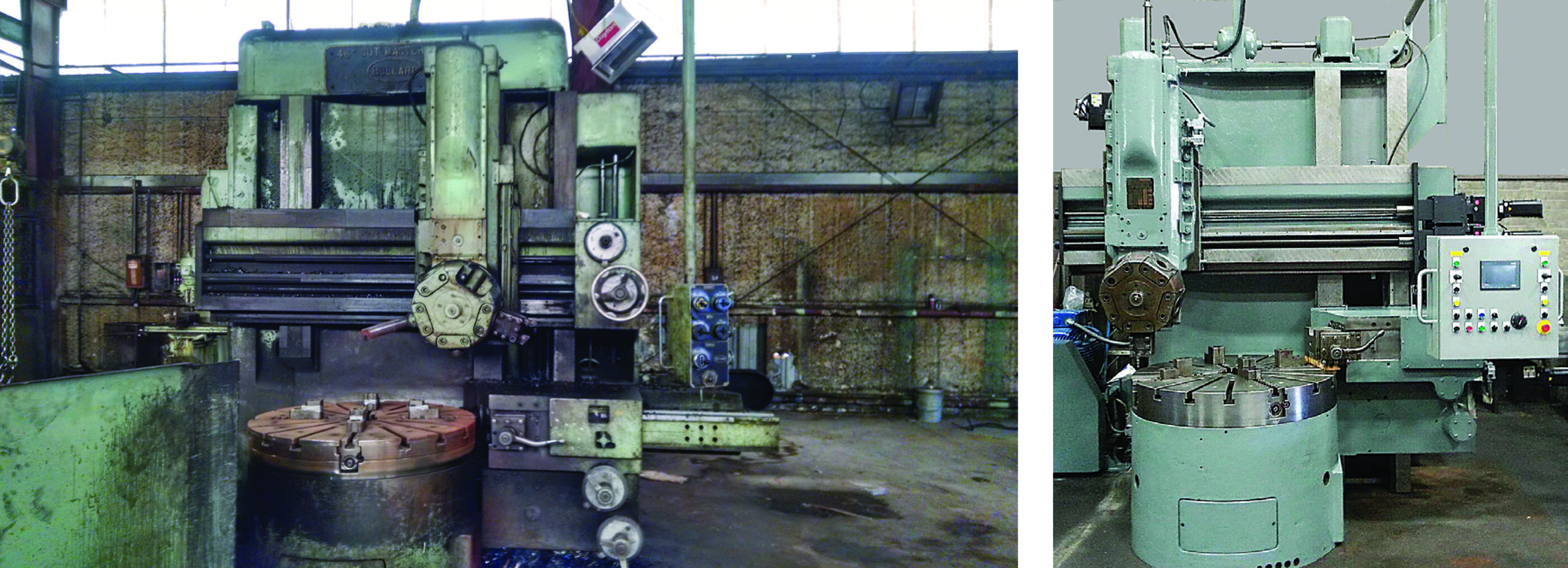

“A complete rebuild means remanufacturing the machine,” said Jim Leigh, president of Pyramid Rebuild and Machine LLC, Tallmadge, Ohio. “It’s replacing the motor, servomotors and drives, ballscrews and nuts, gearboxes, wiring and control, then realigning the axes for proper geometry and working accuracy.”
A 46" Bullard vertical turning lathe before and after rebuilding. Images courtesy of Pyramid Rebuild and Machine.
About the only original element that stays is the iron, Leigh said, which on older machines is “30 or 40 years more stable than when it left the factory.” He warned that rebuilding is expensive, but the result is a machine that is as good as, and often better than, the original.

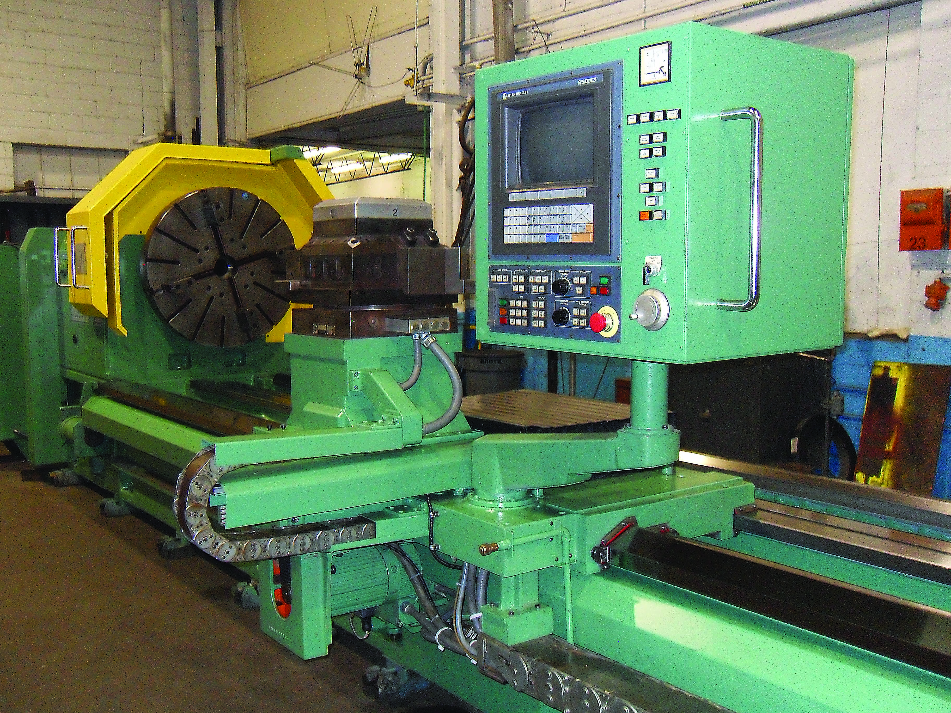

To turn a manual knee mill into a CNC machine requires installation of servomotors; positional feedback mechanisms, such as glass scales or rotary encoders; and a CNC. This is called a retrofit. The machine that is being retrofitted should be in excellent mechanical condition—otherwise it’s like putting lipstick on a pig.
An end user can get a like-new machine by rebuilding it, which means stripping it down to the iron, scraping the ways and replacing the electronics, bearings and other mechanical components, then giving the machine a fresh coat of paint.
The next level beyond rebuilding is remanufacturing. This means doing everything just listed plus equipping the machine with additional, usually custom, capabilities, such as adding a grinding head or live tooling.
