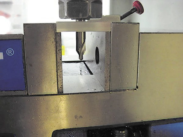

Gross Z negative errors in a program translate into gross machining errors. In this example, the center drill was mistakenly programmed to go Z-1.0 instead of Z-0.1, which resulted in a scrapped part. Machinists should visually scan a new program to check for these types of errors. All images courtesy J. Harvey.

Check the Z negative moves in a new program to see if they make sense. This is an easy way to avoid crashes. For example, if your first tool is a center drill and you are drilling a plate, the Z negative move for the center drill should be somewhere around Z-0.150. If the value in the program is something like Z-1.150, something is wrong.

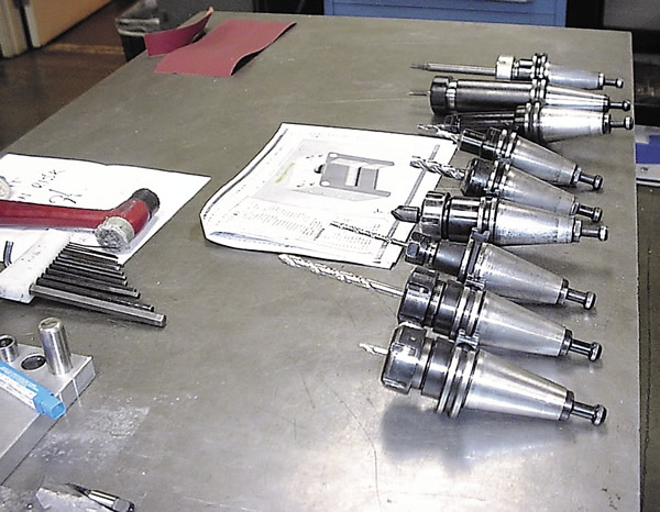

It’s wise for machinists to physically lay out all the tools used in a program in sequential order before installing them in a machine.
