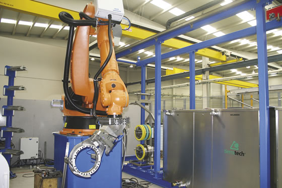

This ultrasonic cleaning tank is used to clean saw blades, with the aid of a robot.
“Most of the applications we work with can be cleaned with an industrial, water-based, biodegradable, alkaline detergent,” said Steve Myers, vice president of engineering and technical services for equipment provider Ultrasonic Power Corp., Freeport, Ill. “It can be used on most metals.”
The rule of thumb is to use an alkaline cleanser when removing oils and metal chips, Myers explained. When removing calcium deposits or rust, a phosphoric acid-based cleanser, which is nonaggressive, works well.
Another concern is proper cleanser concentration in the solution. “Not every soap is the same,” said Tierra Tech’s Manley. “We produce one where the soap is 3 to 5 percent or more of the solution. So it is important when adding detergent to add the correct amount per the manufacturer’s guidelines for temperature and safety.”
Eventually, the solution will be exhausted after cleaning a certain number of parts and a user needs to change, or “recharge,” the solution. The process is simple: Drain the tank, fill it with fresh water and add detergent. An ultrasonic tank cleans itself when parts are cleaned, but the user must keep the equipment consoles clean and thoroughly rinse the tank before switching cleansers.

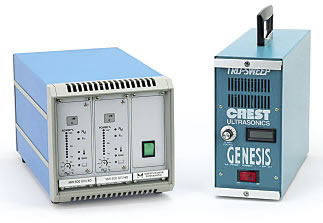

An ultrasonic generator converts a standard 60 Hz electrical frequency into high-frequency pulses from 20 to 200 KHz that are applied to transducers mounted to the tank. Most industrial ultrasonic cleaning uses 40 KHz as the base frequency.
The transducers expand and contract with these pulses, creating acoustic energy in the solution. It is this acoustic energy that creates the alternating high- and low-pressure sound waves leading to cavitation. During the low-pressure phase, the bubbles grow from microscopic size until, during the high-pressure phase, they compress and implode.

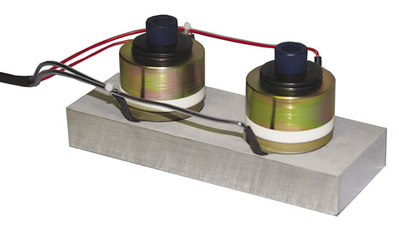

Multiple-frequency systems consist of two piezoelectric transducer stacks, which permit generation of simultaneous multiple frequencies.
The higher the frequency, the smaller the bubbles, with milder implosions for more delicate cleaning or for submicron-particulate removal.
“The lowest frequency we offer is 25 KHz,” said Crest’s Kaczorek. “On the high end, we offer 132 KHz, 192 KHz, 360 KHz, 470 KHz and even 1,000 KHz. Those units target specific industries and contaminants.”
Higher end ultrasonic cleaning systems use more advanced technologies, such as multiple frequency and sweep frequency. Multiple-frequency systems consist of two piezoelectric transducer stacks, which permit generation of simultaneous multiple frequencies.
“The two stacks resonate at 40 KHz,” UPC’s Myers said. “When they propagate into a bar in between the stack, in our case the Vibra-Bar, that bar’s natural kilohertz frequency mixes with the 40-KHz frequency, so you end up with a range of frequencies in the tank that go from the base frequency of 40 KHz up to 90 KHz. The higher frequencies initiate the cleaning by loosening contaminants in inaccessible areas, such as tapped holes and undercuts. This allows the lower frequencies to rapidly and thoroughly complete the cleaning operation.” Multiple-frequency systems from other high-end ultrasonic cleaning manufacturers operate somewhat differently, but the principle is the same.
Sweep-frequency circuitry drives the transducers between a bandwidth slightly greater and slightly less than the resonant frequency. This eliminates standing waves in the tank. “We have a set resonance frequency with a 1-KHz frequency sweep around that resonance,” Frank said. “Cavitation occurs between the high- and low-pressure waves. A single unswept frequency produces specific wavelengths within the solution, resulting in areas of high-intensity cavitation and dead spots where little to no cavitation occurs. Sweeping the frequency continuously changes the wavelength, resulting in even cavitation intensity throughout the tank.”
Depending on the manufacturer, sweep frequencies range from ±0.5 KHz to ±1 KHz to ±2 KHz.

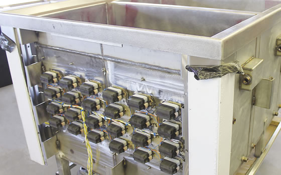

There are two types of ultrasonic transducers used in ultrasonic cleaning systems: the more common piezoelectric and magnetostrictive. Blue Wave uses magnetostrictive transducers, which are known for their durability.
![Blue%20Wave%20Transducer%20Installed.tif](/sites/www.ctemag.com/files/article_images/Blue%2520Wave%2520Transducer%2520I_opt.jpeg)
Courtesy of Blue Wave Ultrasonics
This Blue Wave ultrasonic cleaning tank is constructed with 24 magnetostrictive transducers welded directly to the tank wall.
Tank size depends on the size or quantity of the parts being cleaned. The number of transducers and generators employed is determined by the tank size. Typical tanks range from 5 to 1,000 gal., and some are even larger.
In general, smaller tanks require fewer watts per gallon or lower watt density. But the pressure waves required to create cavitation are reflected off the tank walls and tank surface. Larger tanks, with larger wall and surface areas, are more efficient at reflecting the pressure waves, lowering the watt density required to create effective cavitation. This is a general rule but tank geometry and parts to be cleaned should also be considered when determining the proper watt density.

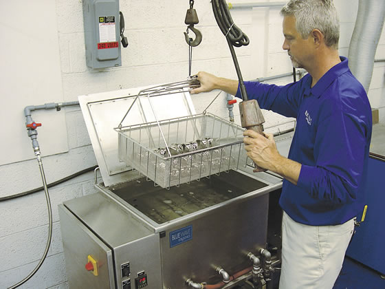

How parts are loaded in an ultrasonic cleaning system is important to make sure the solution contacts every surface.
In addition, Kaczorek recommends only filling a basket 30 to 40 percent full to achieve homogeneous distribution of the cavitation. Also, never place parts directly on the surface where the transducers are mounted because it would block the cavitation process. And there should be about an inch of space from the top of the tank to where the solution is for better efficiency.
