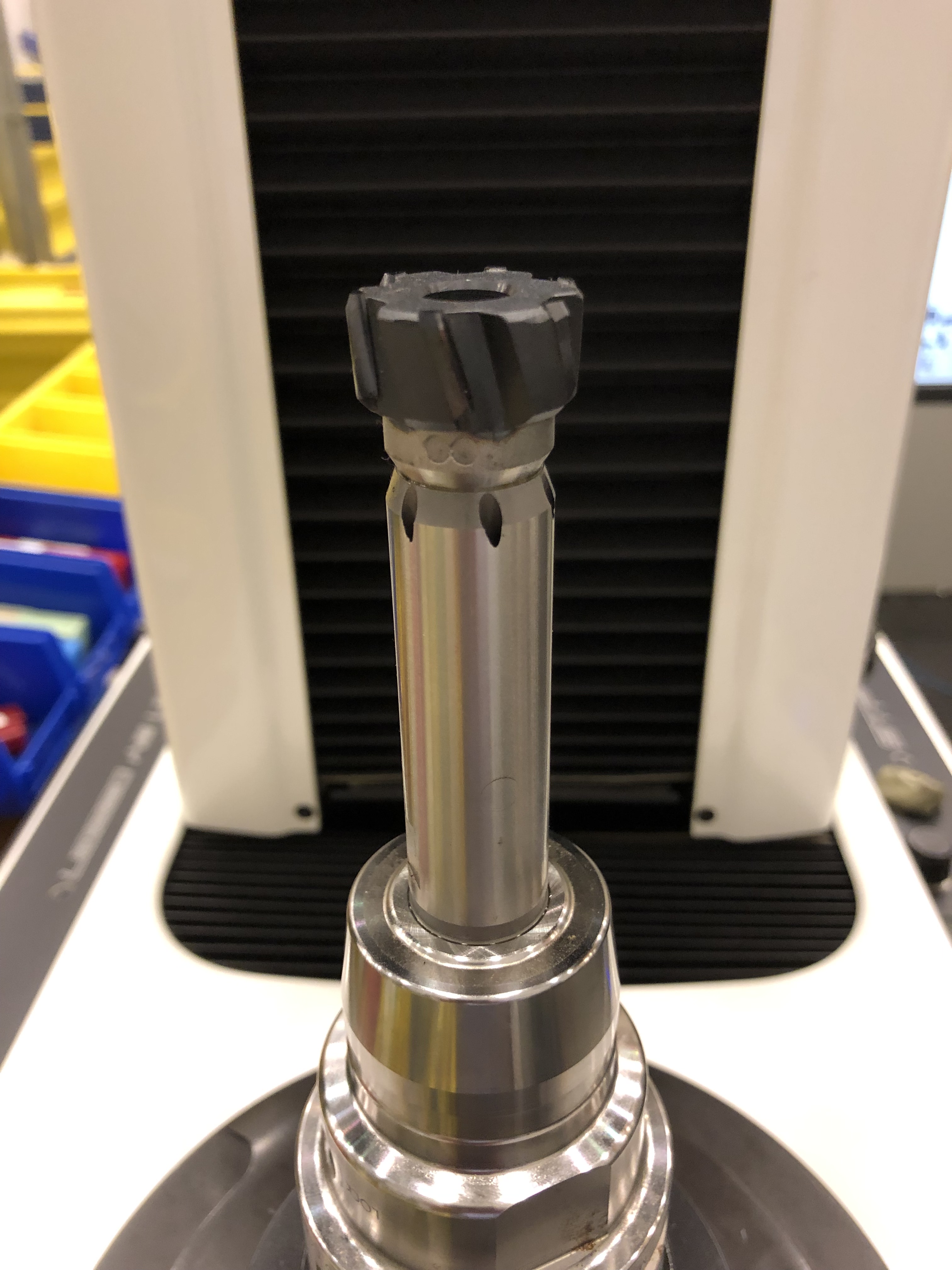

This reamer has a replaceable carbide head, making sharpening easy and allowing users to quickly change sizes with minimal downtime. This style is efficient for repair operations in which volume is low and fast changeover is desired. Image courtesy of C. Tate

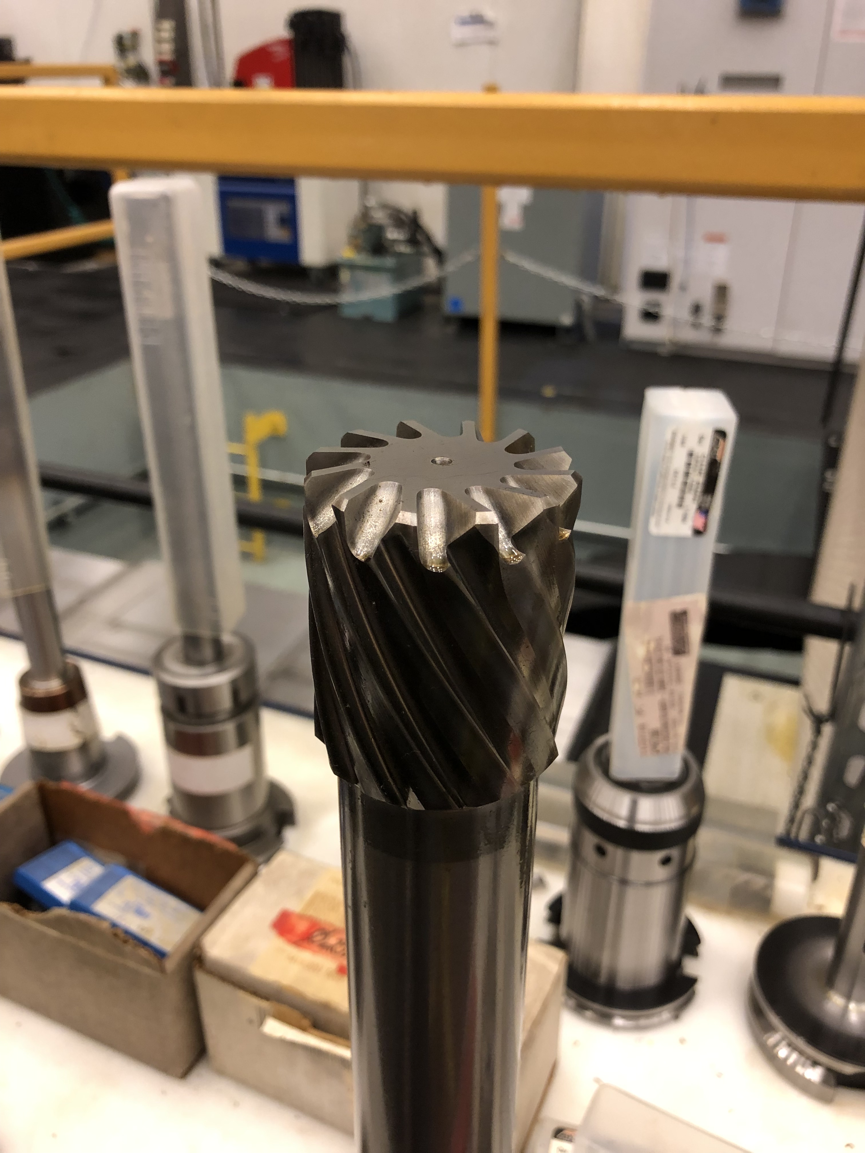

Reamers are available in countless sizes and styles. This reamer has spiral flutes, which enhance chip flow like the spiral flutes on a drill. Image courtesy of C. Tate
Reamers are end-cutting tools. Although their flutes appear capable of side cutting, like endmills, the lip of a flute does not cut. The corner where the flat end and the flutes meet is where work is done. Corners are never square. They usually are chamfered and sometimes have a radius. Corner geometry of the reamer allows it to enter the hole in a way that prevents it from altering the center location of the hole. The noncutting lip of the flute acts as a guide that supports the body of the reamer while in the hole, which stops the tool from wandering off the toolpath. The burnishing action gained from the noncutting lip also enhances surface finishes. When speeds and feeds are optimized, reamers impart a fine finish.

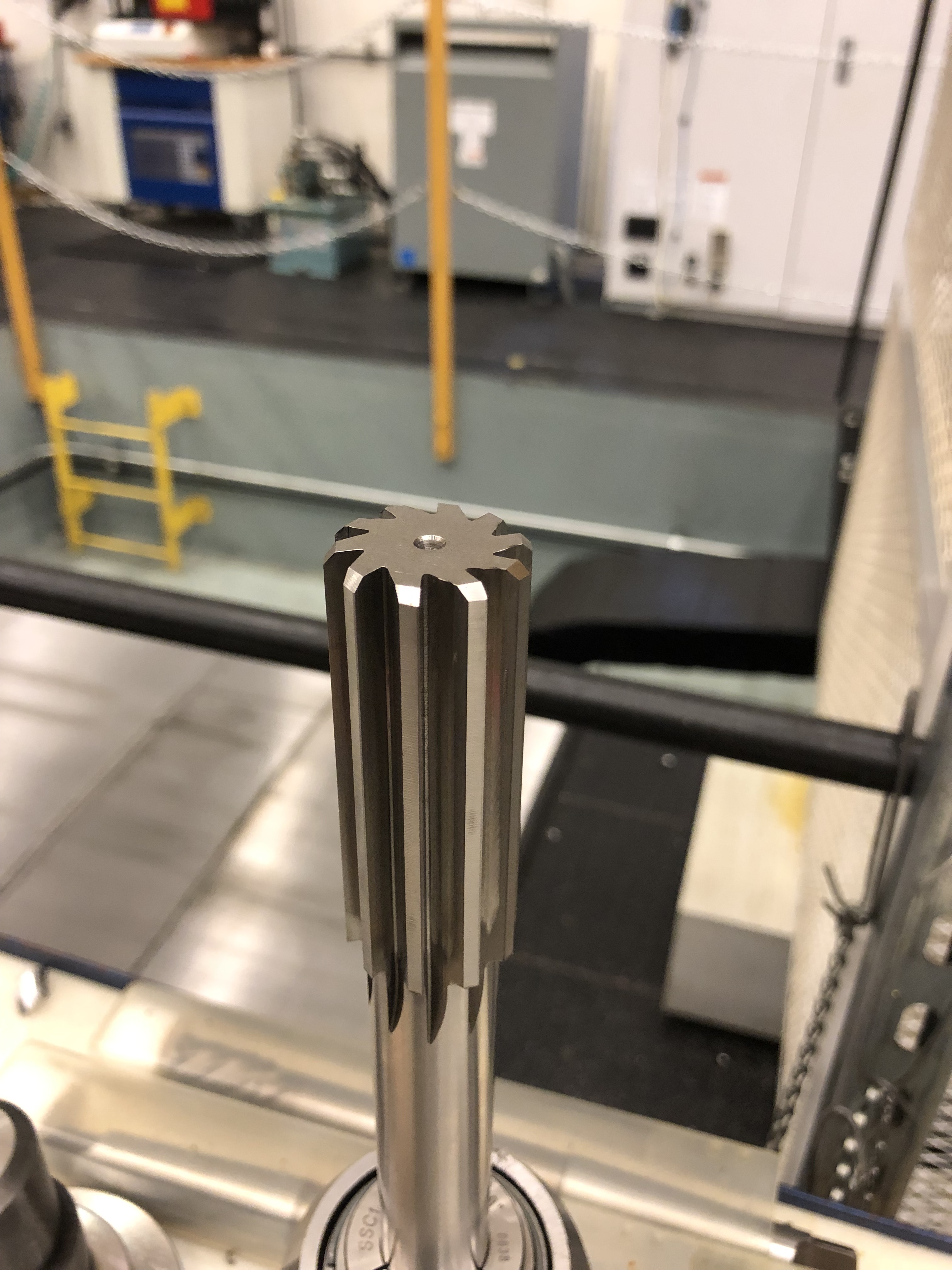

Known as a chucking reamer, this is by far the most common type of reamer. It is inexpensive and effective for the majority of applications. Image courtesy of C. Tate
