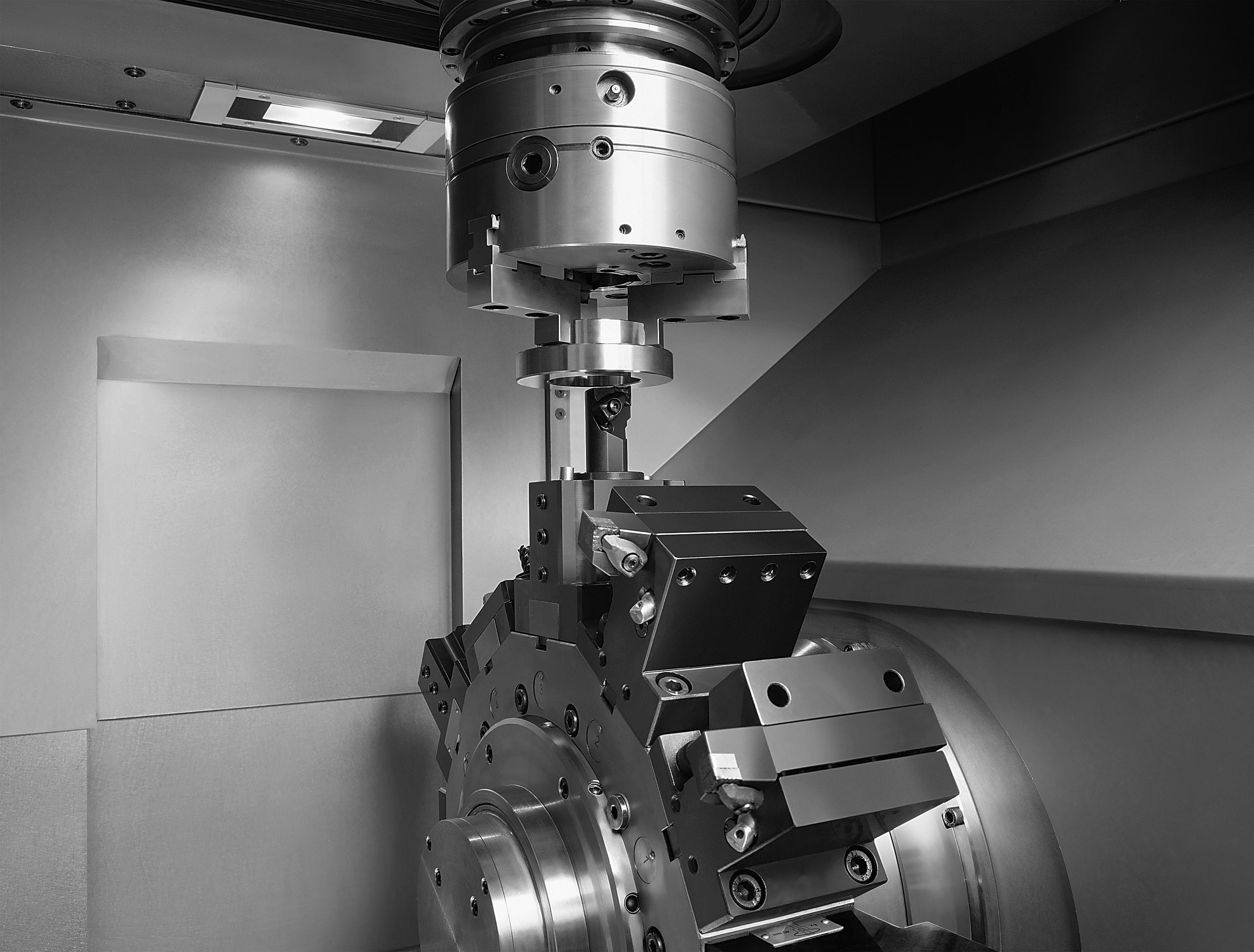

Several machine tool builders offer VTLs that avoid this problem. By inverting the spindle, chip problems are virtually eliminated. This approach also provides nearly free automation. By using the spindle as you would a robot—picking up parts from an onboard conveyor or carousel and unloading them—throughput is increased without the hassle of robot integration, programming and gripper management.

Stewart cited the various benefits of an inverted VTL machine structure: First, because chips don't fall onto the workpiece, there's no chip re-cutting as there is on a traditional VTL. In addition, the machine's scales, motors and drive components are above the work zone. Therefore, coolant and its associated contaminants are not "going into the expensive part of the machine." Also, the ability to automatically self-load and unload parts is a given on any inverted VTL.

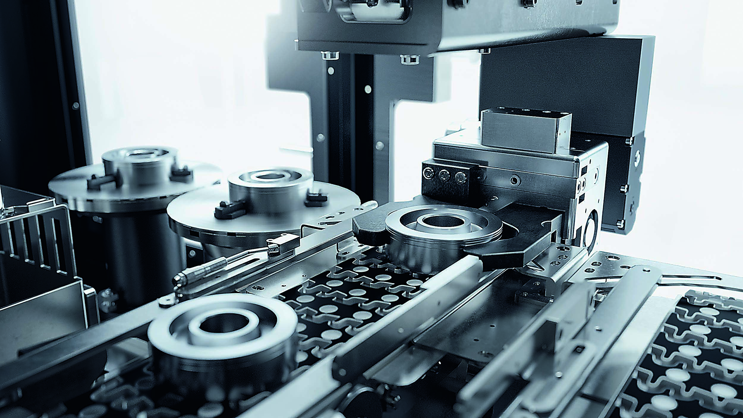

In EMAG's case, this loading and unloading is done with a racetrack-style carousel equipped with V-shaped, self-centering workpiece-blank locators. "In the case of an inverted VTL, such as our VL2 and VL2 DUO," Stewart said, "the cutting tool remains static on the indexing turret. Meanwhile, the spindle, together with the workpiece, is moving in the X and Z axes above it." As a result, Stewart added, the user has the ability to take the workpiece to an unload location, index the carousel or shuttle to pick up a raw part and then take it back to the turret for machining. "It's this difference in machine architecture that allows these machines to be self-loading."
To pick up a part without mashing it into the spindle, a gimbal plate with four heavy-duty die springs is mounted in the loading position. When the spindle comes down to grab a new blank, the springs compress enough so any Z-axis deviation is absorbed, preventing damage to the spindle and chuck. The mechanism is also equipped with sensors to detect any misloading or misalignment issues and stop the machine in the event of a problem.
Why bother with this sort of merry-go-round approach when robotic part handling is both effective and readily available? Stewart said, in this instance, conventional robots have several strikes against them, including a larger footprint and the need for cages or light curtains to ensure operator safety. In addition, end users typically place a robot in front of the machine, making it more difficult for the operator to access the control and tend cutting tools.
However, with a carousel, an operator can easily manage the machine and load it with enough blanks to keep it busy for hours of unattended machining. If a shop does want to use a robot, it's simple enough to mount one to the side of a VTL, where it is out of the way and can tend to the carousel.

Rob Nash, Charlotte, N.C.-based account manager for machine tool builder Scherer Feinbau GmbH, a German company that is part of the Chiron Group, pointed out several additional advantages of inverted-spindle machines: "Because the critical components are not exposed to heat, chips and cutting fluids, machine longevity is generally better. Maintenance is a matter of lifting a couple of covers." He explained that the machine is inherently more accurate and, thanks to gravity, more stable, permitting heavier cuts and improved tool life.

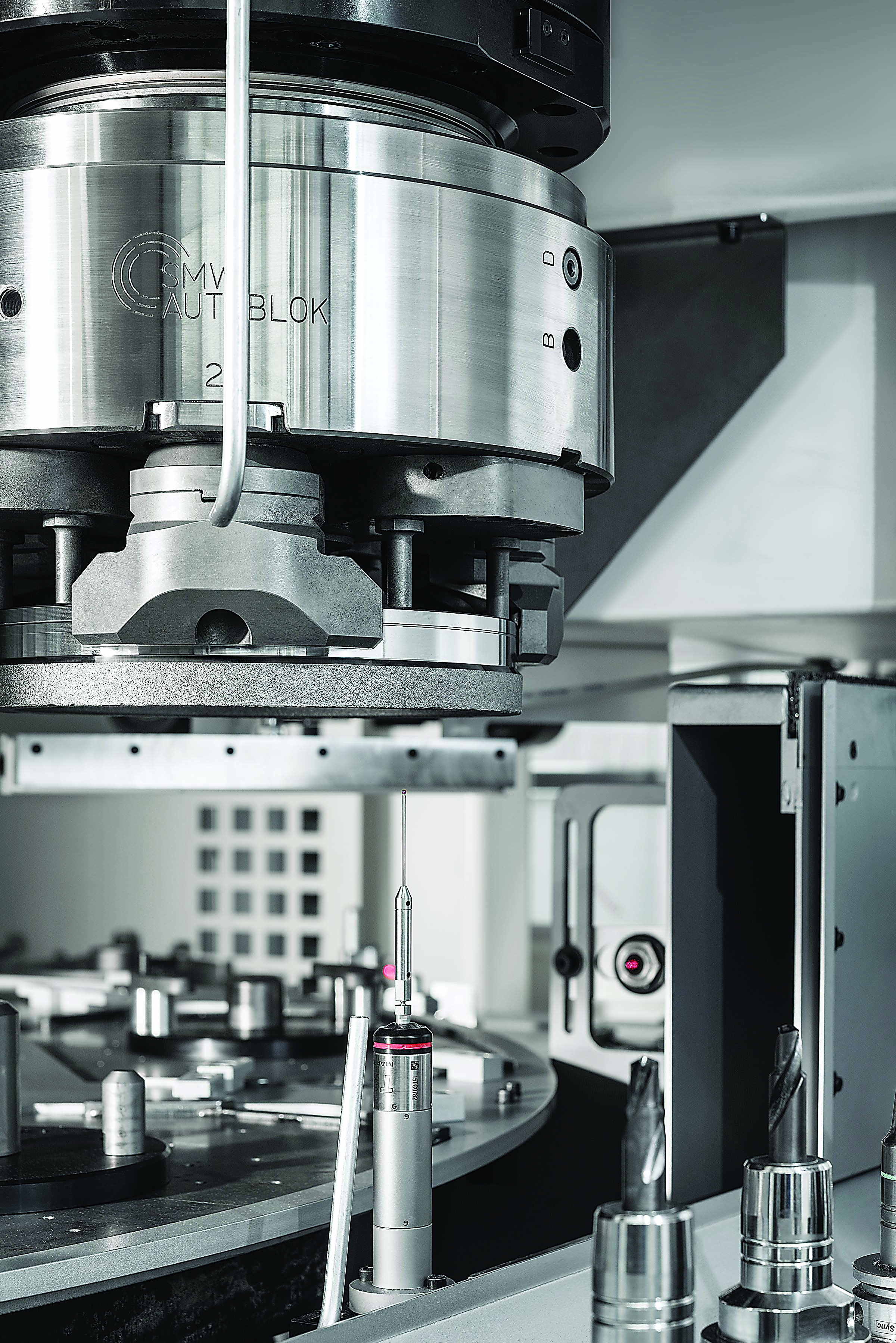

Despite the fact that the majority of inverted machines find homes in high-volume automotive shops, Bramstedt said there's no reason one can't be used in a job shop, provided the quantities justify it. "The machines are programmed the same way, the tooling is the same, and you have the built-in automation. If you have a family of parts with a few hundred parts to run, for example, it would do a fine job. But to be honest, most people in this situation go with a traditional VTL. That's because, in most cases, an IVS installation is very application-specific, and by the time you're done tooling one up with workpiece conveyors and gaging and special workholding, it can get pretty expensive."
