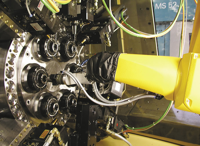

Robotic part handling increases spindle capacity and reduces floor space requirements.
Robotic part handling increases spindle capacity and reduces floor space requirements. Image courtesy INDEX.

All multispindles operate on a share-the-workload principle. Each spindle typically has two (or more) slides: one for end-working operations, such as drilling and boring, and the other for turning, grooving and cutoff. On a 6-spindle machine, for example, the first spindle/slide station might turn and drill, the second station might counterbore and groove and so on until the part is completed. The part cycle time is determined by the longest of the six operations, which is why it's important to level the machining load across all stations.

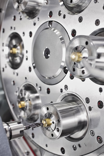

Counter-rotating end-working spindles increase operational spindle speeds.
Counter-rotating end-working spindles increase operational spindle speeds. Image courtesy Tornos Technologies.
All those moving parts might sound scary, but Principe said programming is actually quite simple. "Anyone who knows CNC can set up one of these machines. It's a matter of programming each operation individually—face and turn on slide one, drill on slide two, tap on slide three—and the control takes care of the synchronization and makes sure that the longest operation is complete before indexing the spindles. There's no way to mess it up."

Another game changer is spindle speed. Where old mechanical machines topped out at a few thousand rpm, some of today's machines boast speeds of 8,000 rpm and higher. And, by using a counter-rotating drill on an end-working station, effective spindle speeds of 15,000 rpm or more are possible.
