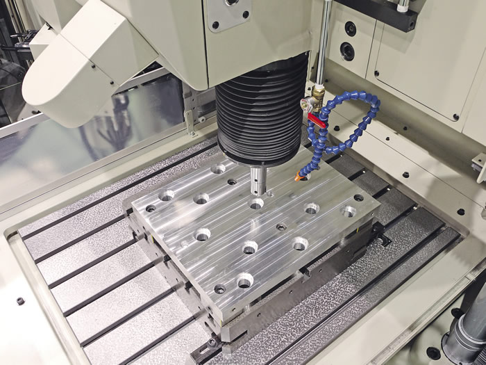

Manufacturers of mold bases use jig boring and jig milling machines to finish bores with tolerances tighter than 5µm in roundness, perpendicularity and straightness. Image courtesy Mitsui Seiki USA.
To achieve the required level of precision, jig borers are designed and built in ways that set them apart from typical machines. For example, jig borers feature components made with tighter-than-normal tolerances, as well as improved rigidity, thermal stability and vibration-damping capabilities, according to Dolan.
