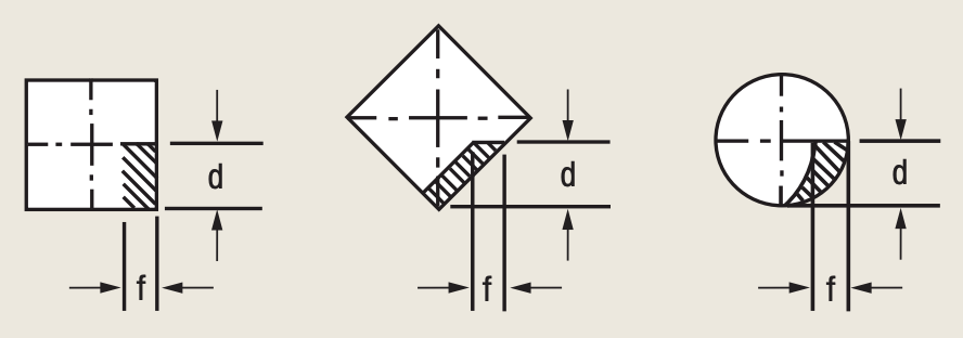

Figure 1. Cross sections of uncut chips produced by square and round inserts.
Because cutting speed is one of the selectable machining parameters, only the cutting force should be calculated to obtain the required machining power.

Cross-Sectional Area
The shape of an uncut chip’s cross section depends on insert geometry and the milling cutter’s lead angle. Round inserts produce chips in the shape of a partial crescent. Inserts of all other shapes with straight cutting edges produce chips with either a rectangular cross section for milling cutters with a 0° lead angle or a parallelogram cross section for milling cutters with lead angles greater than 0°. Cross sections of the chips produced by square inserts (0° and 45° lead angles) and a round insert are shown in Figure 1.
The cross-sectional area of the chip (A) is a product of the axial DOC (d) and feed per tooth (f):
A = d × f (4)
Formula (4) is easily understood when applied to rectangular and parallelogram cross-sectional areas, but it is not so obvious when the formula is applied to a cross-sectional area of a chip produced by a round insert. Then, the cross-sectional area is either a half-crescent when the axial DOC equals the insert’s radius, or smaller than a half-crescent when the axial DOC is less than the insert’s radius. The applicability of formula (4) for crescent-like areas has been proven by integral calculus and algebraic-trigonometric calculations.

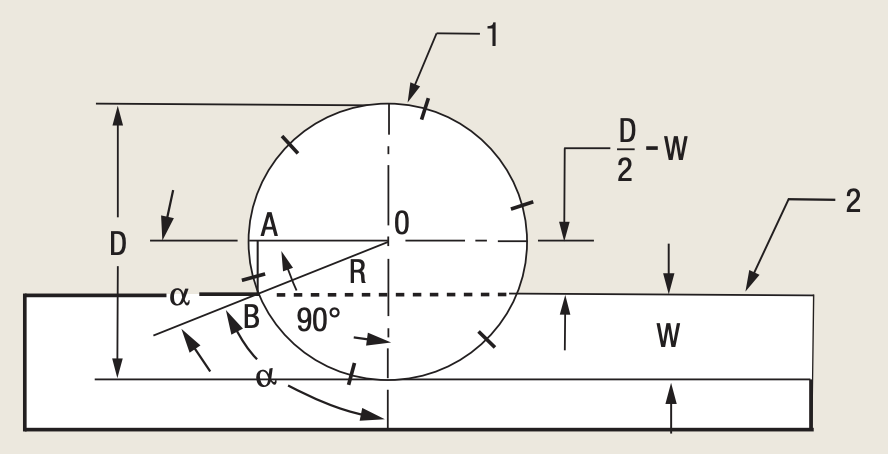

Figure 2. The centerline of the cutter (1) is located on the workpiece (2).
Figure 2 shows a cutter’s centerline on a workpiece, with the engagement angle greater than 90°. The maximum engagement angle possible is 180°, occurring when the radial WOC equals the cutter diameter. In such a case, half of the inserts are engaged with the workpiece material. If the radial WOC equals the cutter radius, only 25 percent of the inserts are engaged with the workpiece. The number of inserts in the cut can be found for any WOC using the following formulas.
As seen in Figure 2, the engagement angle (α) equals 90° plus α1, where α1 is the angle between the cutter diameter and the cutter radius R drawn to the peripheral point B at the entry or exit.
From the right-angle triangle OAB:
sin α1 = AB ÷ OB = (W – R) ÷ R = (W – D ÷ 2) ÷ (D ÷ 2) = (2W – D) ÷ D,
α1 = arc sin [(2W – D) ÷ D] and the engagement angle is:
α = 90° + arc sin [(2W – D) ÷ D] (6)
Substitution of α from formula (6) into formula (5) gives:
ZC = Z × (90° + arc sin [(2W – D) ÷ D)] ÷ 360 (7)

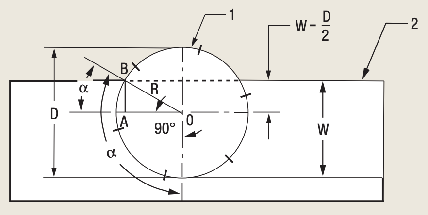

Figure 3. The centerline of the cutter (1) is not located on the workpiece (2).
Figure 3 shows a cutter’s centerline that is not located on a workpiece, so the radial WOC is less than the cutter radius. Therefore, the engagement angle is less than 90°.
As seen in Figure 3, the engagement angle (α) equals 90° minus α1, where α1 is the angle between the cutter’s centerline and the cutter radius R drawn to the peripheral point B at the entry or exit.
sin α1 = AB ÷ OB = (R – W) ÷ R = (D ÷ 2 – W) ÷ (D ÷ 2) = (D – 2W) ÷ D,
α1 = arc sin [(D – 2W) ÷ D] and the engagement angle is:
α = 90° – arc sin [(D – 2W) ÷ D] (8)
Substitution of α from formula (8) into formula (5) gives:
ZC = Z × (90° – arc sin [(D – 2W) ÷ D)] ÷ 360 (9)

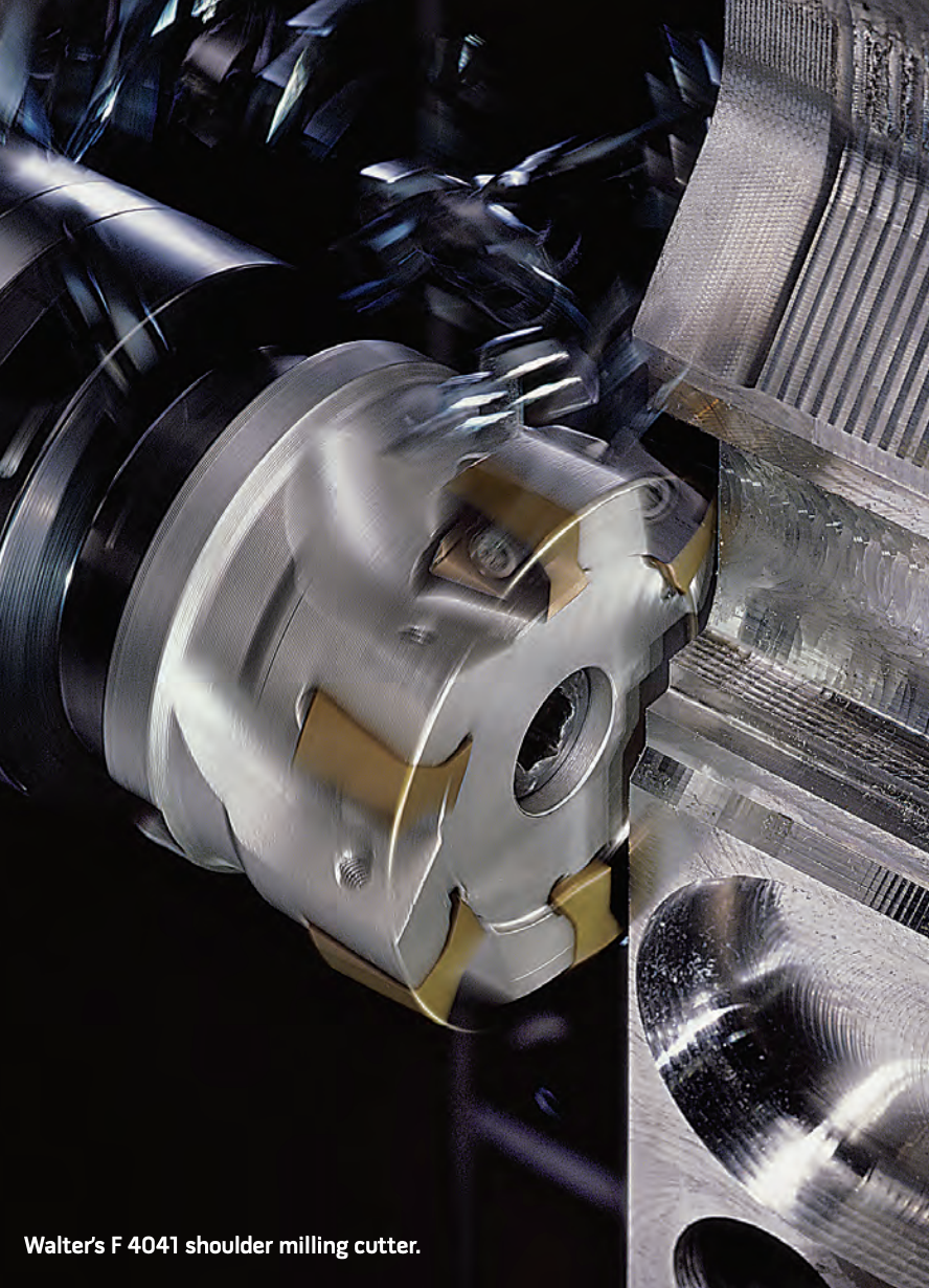

The following machining power calculations are performed using the conventional method and the new method to compare them.
 The work material is annealed AISI 4140 alloy steel with a Brinell hardness of 180 HB. According to Walter USA LLC’s material classification, 4140 alloy steel belongs to group 6.
 The cutting tool is Walter’s shoulder milling cutter F 4041.
Description, 4041.UB.102.Z08.13
Diameter, DC = 4.0 "
Number of inserts, Z = 8
Approach angle, κ = 90° (similar to a 0° lead angle)
Coated grade, WKP 25
 The machining data for roughing was adopted from Walter’s general catalog from 2007.
Starting value for cutting speed, VC = 850 sfm
Feed rate per tooth, fZ0 = 0.006 "
DOC, ap = 0.400 "
WOC, ae = 2.6 "
ae ÷ DC = 0.65
