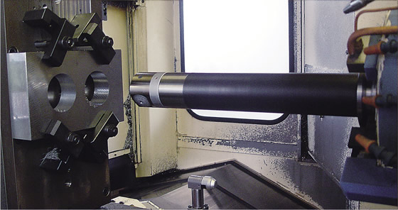

BIG_Daishowa_Smart_Damper_Action.tif
BIG Daishowa's SmartDamper bored the hole on the left. The tool imparts a finer surface finish and offers longer tool life than boring tools without a damping system, such as the one that bored the substandard hole on the right, according to BIG Kaiser. BIG Kaiser Precision Tooling.
