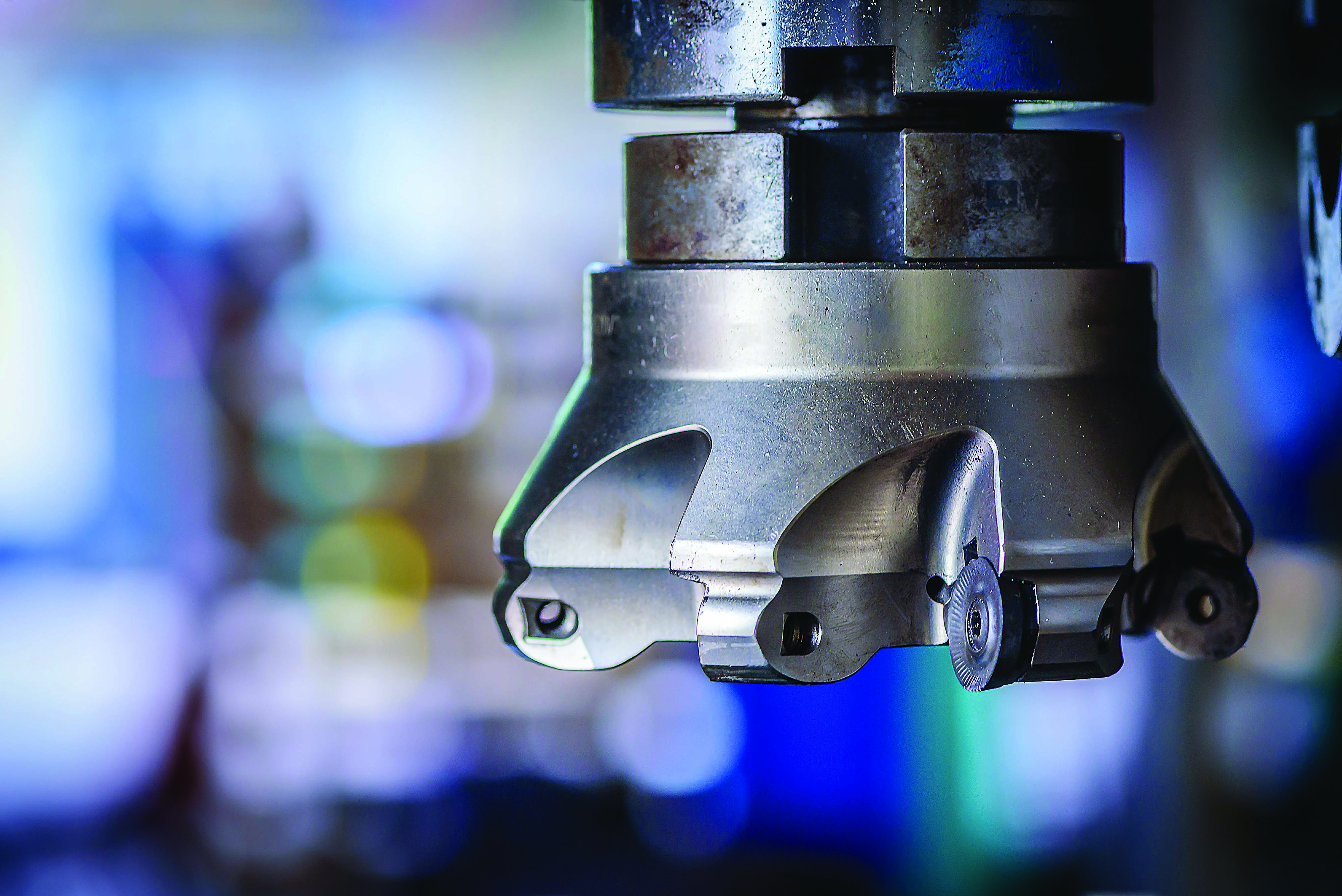

When it comes to cutting angles, the rake can make or break your facemilling process. Rake angles impact key parameters, such as chip flow, metal removal rate and tool life. So rake angles need to be chosen with an eye to the requirements of each application.
For cutters with indexable inserts, the rake angle is the inclination of an insert’s cutting face. There are two types of rake angles. The axial rake angle is the angle between the cutting edge and the axis of the cutter. This angle affects the facemilling process in several ways. It directs chip flow and impacts cutting-edge strength. In addition, toolmakers use the axial rake angle to control power consumption, said Nate Peters, senior tool design engineer at Greenleaf Corp. in Saegertown, Pennsylvania.

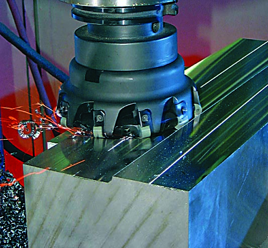

 A facemill cuts with a negative axial rake angle.
A facemill cuts with a negative axial rake angle. Image courtesy of Greenleaf
On the downside, Stusak pointed out that the double-negative design directs chips toward the workpiece and sometimes creates a burr. The design also subjects the workpiece, inserts and machine spindle to high cutting forces.

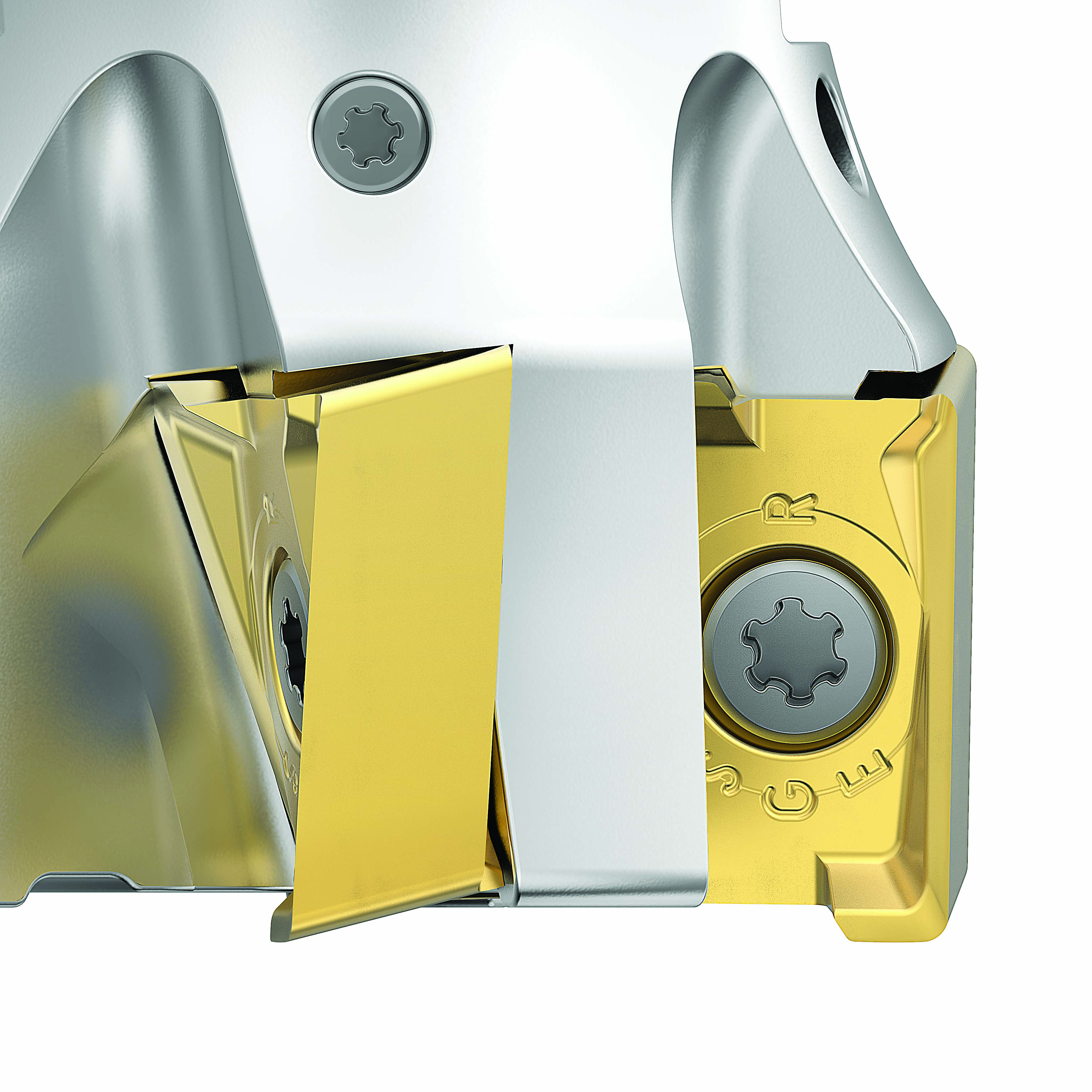

When using a double-positive rake angle, the cutting edge of an insert needs to withstand larger forces. The edge requires a strong, stable design so it won't break or wear too quickly.
When using a double-positive rake angle, the cutting edge of an insert needs to withstand larger forces. The edge requires a strong, stable design so it won’t break or wear too quickly. Image courtesy of Kennametal
