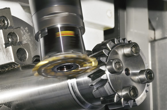

In this multiaxis gear-milling process, multipurpose machines are fitted with tools composed of off-the-shelf inserts for making spur and helical gears. It can produce spur and helical gears using a disc-shaped milling cutter tooled with grooving inserts. With simultaneous motion of the X and B axes or the Y and B axes, the tool follows an involute path. Consequently, variations in gear shape are produced according to the toolpath—not the shape of the tool. For this purpose, mill/turn machines are ideal.
![120294.tif](/sites/www.ctemag.com/files/article_images/120294_opt.jpeg)
When involute milling the tooth space of an outer spur gear, a groove is facemilled in an axial direction on the workpiece. For the following cuts, the gear wheel rotates slightly, coordinating with the simultaneous radial plunging of the InvoMilling tool, creating an involute curve shape.

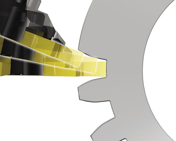

InvoMilling is a combination of slot milling and turn milling. It enables machining of gears of any helix angle—both involute and noninvolute profiles—with the same tools. This series illustrates the process.
Step 1: slot milling.

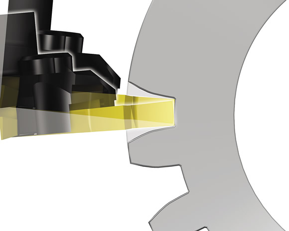

Steps 2 and 3: machining the root and protuberance.

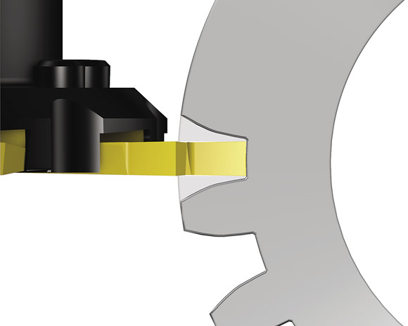

Step 4: turn milling the lower gear tooth profile.

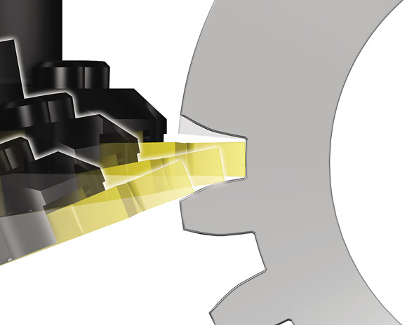

Step 5: turn milling the upper gear tooth profile.

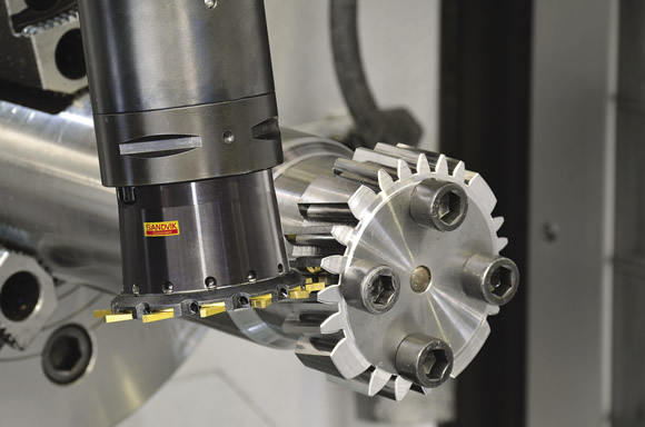

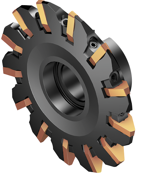

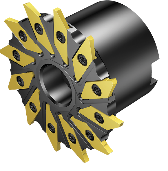

InvoMilling software for the NT machine immediately enables manufacturing different types of gear wheels. Gear-making cutter kits with three tools—CoroMill 161, Coro-Mill 162 size 4 and CoroMill 162 size 6—cover the range from module 2 to 12, or 12 to 2 DP (diametral pitch).
The price of a kit is similar to that of one dedicated inserted hob. The kit can be used to produce a range of modules, while the hob can only produce one single module, albeit more quickly.
Involute milling is a combination of slot milling and turn milling. It machines gears with any helix angle—both involute and noninvolute profiles—with the same tools. The number of cuts involved depends on the size of the gear and the size of the cutters being applied.
This method makes use of the advanced machine control and high accuracy of the NT mill/turn machine and the cutters to make finished gears on the machine as well as semifinished gears to be ground on a separate machine. Applying the latest developments in insert grades has also enabled a high level of cutting data to be applied for optimal efficiency.
In addition, chamfers at the gear tooth’s OD can be machined during involute milling, as well as protuberance angles, profiles and radii at the tooth’s base. The cutting forces with this process are considerably smaller than with hobbing, so larger tooth forms can be made in smaller machines.
For example, when involute milling the tooth space of an outer spur gear, a groove is milled in the axial direction on the workpiece. In the following cuts, the gear wheel rotates slightly, coordinating with the simultaneous radial plunging of the cutting tool, producing an involute curve shape. For larger gear modules, more cuts may be necessary. For wider gears, the cutter is offset in the axial direction and the procedure is repeated.

Involute milling can produce spur and helical gears using dedicated milling cutters, such as CoroMill 161 (top) and two sizes of CoroMill 162 (above), which together cover modules 2 to 12.
