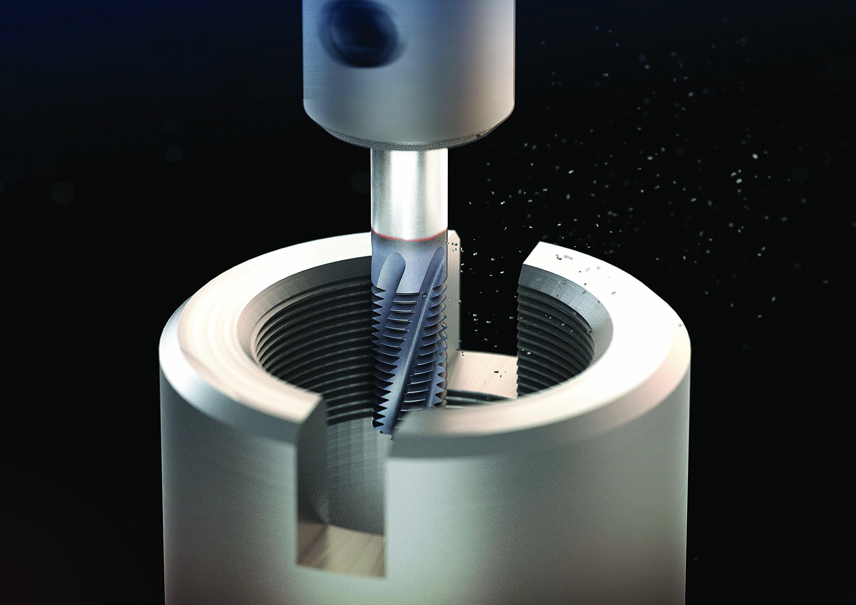

Courtesy of OSG Tap & Die
When threading axial holes at the top of hip-replacement stem components like these made from cobalt chrome, Thortex switched from conventional taps to OSG EXOCARB thread mills (below) and increased tool life by more than 10 times.
