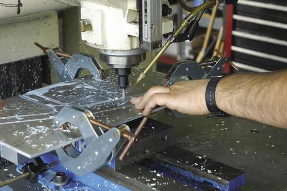

Carefully hold your hand on the part when using tricky or dicey setups because your hand will detect a part shifting before your eye will.

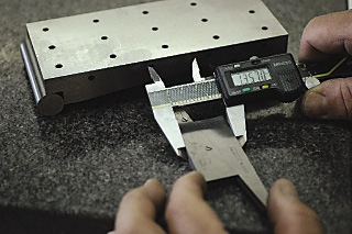

Always caliper a stack of gage blocks to confirm your math.
  • Hold your hand on the part when using tricky or dicey setups. Your hand will detect a part shifting before your eye will, giving instant feedback to the other hand that’s cranking the feed handle.

  • Use a gage pin to quickly set your sine bar. This can eliminate stack-up math errors using gage blocks. As a safety measure, always caliper a stack of blocks to confirm your math.
