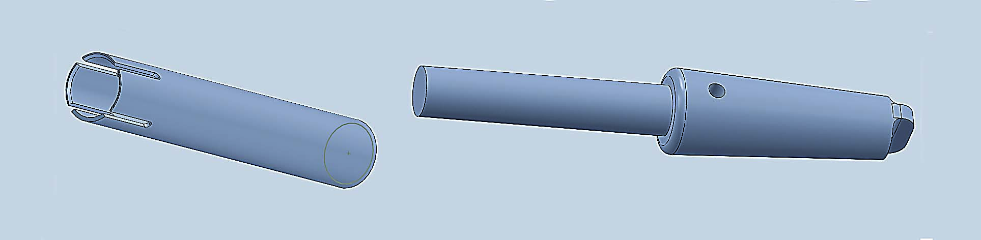

A less expensive and common substitute for a bar feeder is a bar puller. Bar pullers are mounted in a spare tool position and grip the end of the cut bar while the turret pulls the bar into position.
To continuously operate while being frugal, we made our own bar puller. It worked so well pulling became our standard method for bar work.
A bar puller can be easily made from a piece of tool steel by boring a hole the same size as the bar stock so there’s a slight interference fit. The depth should be about twice the bore diameter. Turn the OD so the wall thickness is about 0.125" (3.175mm). Next, mill or saw axial grooves in the wall so the puller has four independent “fingers” that can flex as it pushes onto a bar. If the puller is not tight enough, simply bend in the fingers a little to increase the interference between the bar and puller ID.
Whether using a feeder or puller, cutoff parts will fall. Machines are often outfitted with part catchers that retrieve and deposit parts so the machine can continuously run. Not having a part catcher meant parts cut off by our machine would fall into the bottom of the machine, making them subject to loss or damage. We found a simple, effective way to catch parts by placing a plastic bar in the tailstock.
When a part was cut off, the tailstock would move forward and place the plastic in the ID of the part, catch it after cutoff and then retract as the operation continued. While not as efficient as a part catcher installed by the machine tool builder, it was effective. Of course, this method has drawbacks. You can’t catch parts that do not have holes, and it is necessary to stop the machine to retrieve the parts.

Bar pullers (left) are mounted in a spare tool position and grip the end of the cut bar while the turret pulls the bar into position. This Morse taper adapter (right) fit into a tailstock and held rods, which would catch parts. Rods of varying diameters could be installed and held in place with a setscrew.
